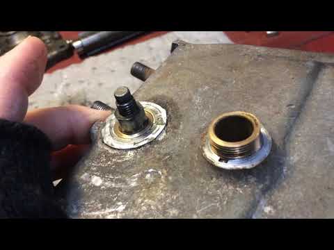

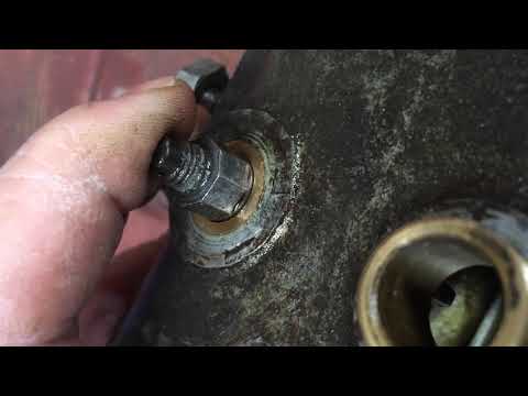

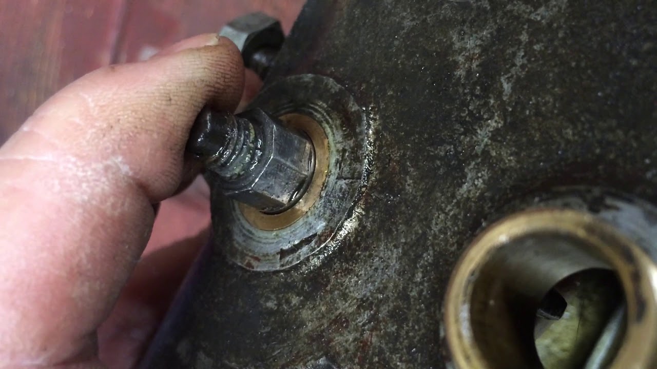

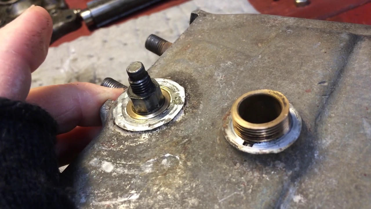

        So, as part of this rebuild, a machinist friend made me new shift segment bushings and precision thrust washers for both transmissions. Here is a video of the loose bushing:
        This next video was made after the new bushing was installed:
        I can't wait to try it on the road.
