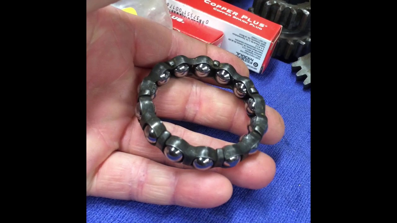

                                I've been working on a couple of transmissions, or as Hendee Manufacturing Company called them, three speed countershafts. I found a second aluminum case in addition to the one I used in the Cannonball bike. I had a spare trans in 2016, but it has the later cast iron case. I decided that, while I'm rebuilding my main transmission, I'd build up a spare with the aluminum case, so it's easier to lift in and out of the moto van. The new case has a couple of chunks broken out of the mounting flange, but it shouldn't affect function. This is pretty common, if people let the mounting bolts get loose the force of the drive chain would twist the case and cause this. Also, the mounting stud holes in the new case had been heli-coiled, but whoever did it drilled them crooked, so a friend redrilled them on his Bridgeport and made some thread inserts.
                                The new case has good main bearing races in it, so I decided to just pop new balls into the cage like I'd done on the other one. Here is the outer race:
                                Here is the inner race before and after I polished it up:
                                You also should polish the spacer because the felt seal rides on it. Here are before, during, and after photos of the process:
                                I know, I need to clean my lathe up.
                                Here's a video I made that shows how to put the new balls in and assemble the main bearing:
                                That's it for today. I hope you find it interesting and helpful.
