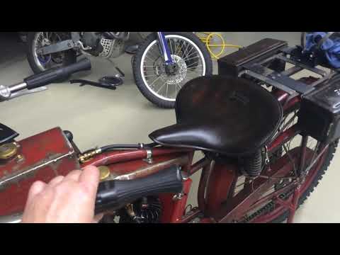

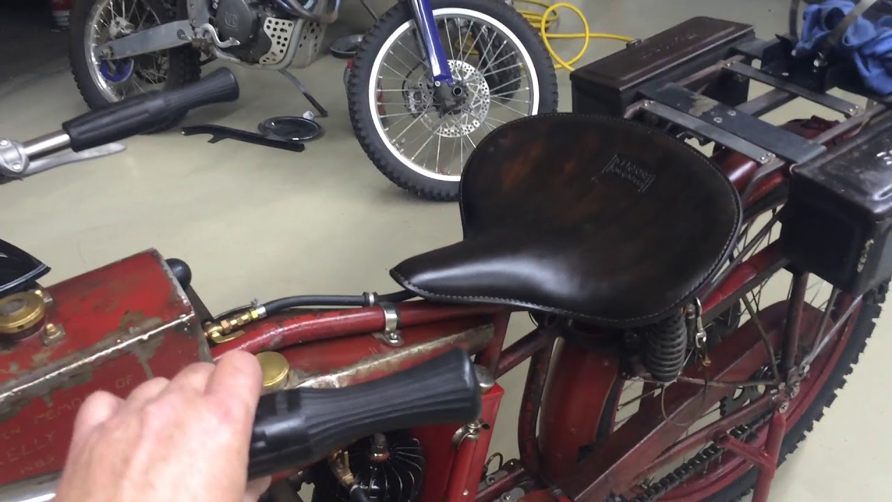

                        This happened tonight. I had to share it. I still have a ton to do.
                        Kevin
                        Kevin

                          #777
                          Kevin,
                          Congratulations on the start up, sounds good!! Bet you're excited to get riding.
                          Yes, Hans did run straight synthetic 2 stroke oil in the crankcase. We had a very lengthy discussion about this and I tried it in the Chief for a while. It ran incredibly clean, not a speck of carbon build up. I decided to go with a conventional oil because with the sidecar, the engine runs very hot and that thin oil made the timing chest clatter, a lot! It sounded like Chinese whore house! (I can only assume). It still is a noisy timing chest when it gets hot but its better with conventional oil.
                          Gene
