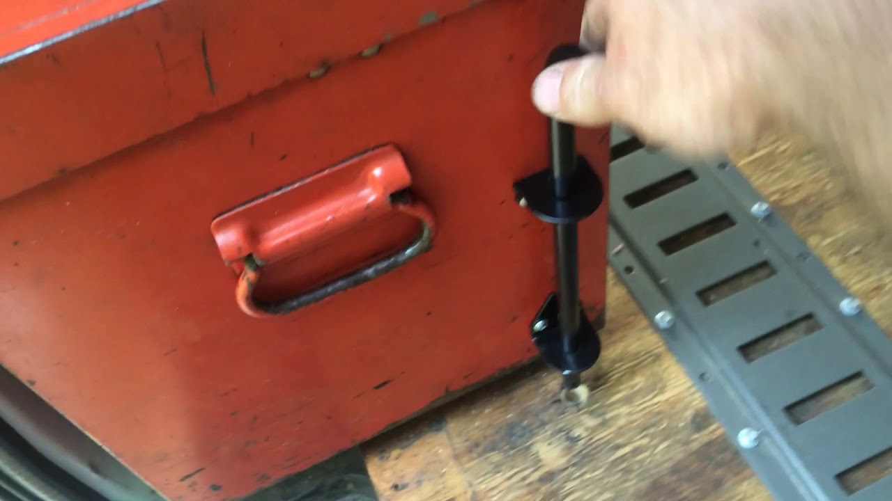

                              Patience is together and working pretty well. The front end has lost its wobble. The transmission shifts like butter. Or as buttery as a non-synchro crash box can be anyway. The clutch is dialed in. The timing has been tweaked. I loosened up the tappet clearances and that is working well. The auto-oiler is working perfectly. The carb adjustments are pretty close. She has about 200 miles on her now, and I'll try to put another hundred or so on before I load her in the van.
                              I've been spending some time making improvements to the MotoVan. Here's a short video of my new toolbox set up:
