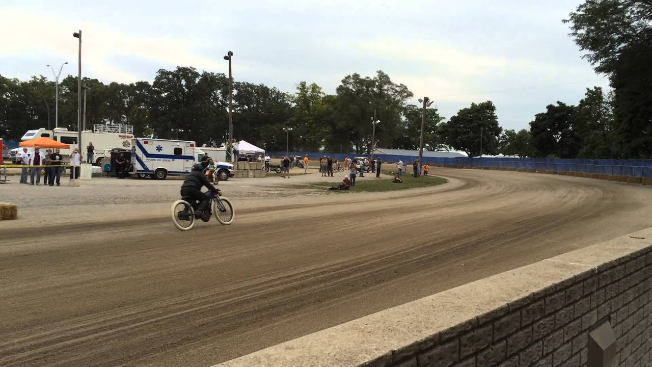

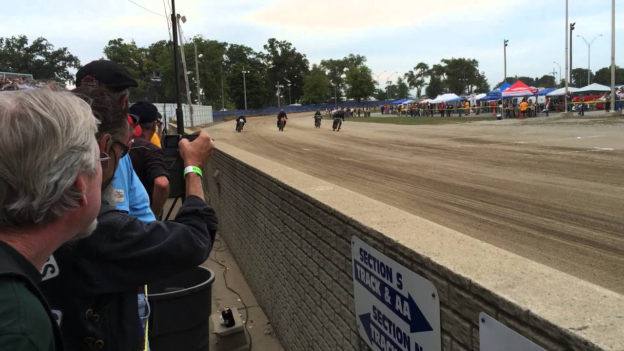

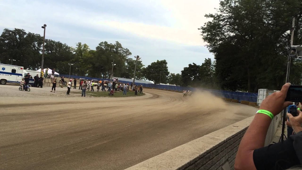

                      I got to watch old motorcycles race:
                      Here are a couple of the bikes that were out there on the track:
                      And get this, Jay Springsteen and Joe Roeder did some exhibition laps:
