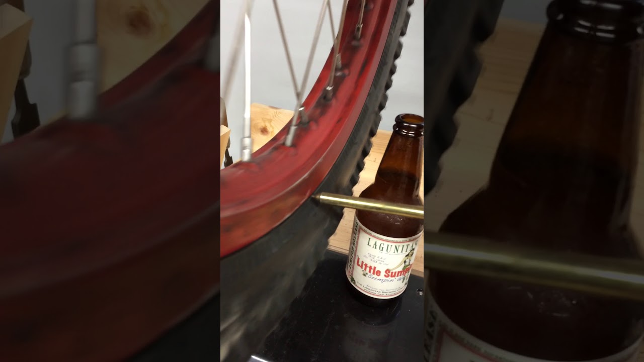

    New rubber on the rear wheel of the 1916 Indian Cannonball bike, #97. Still round after 4,000 hard miles. Isn't that Sumpin'!

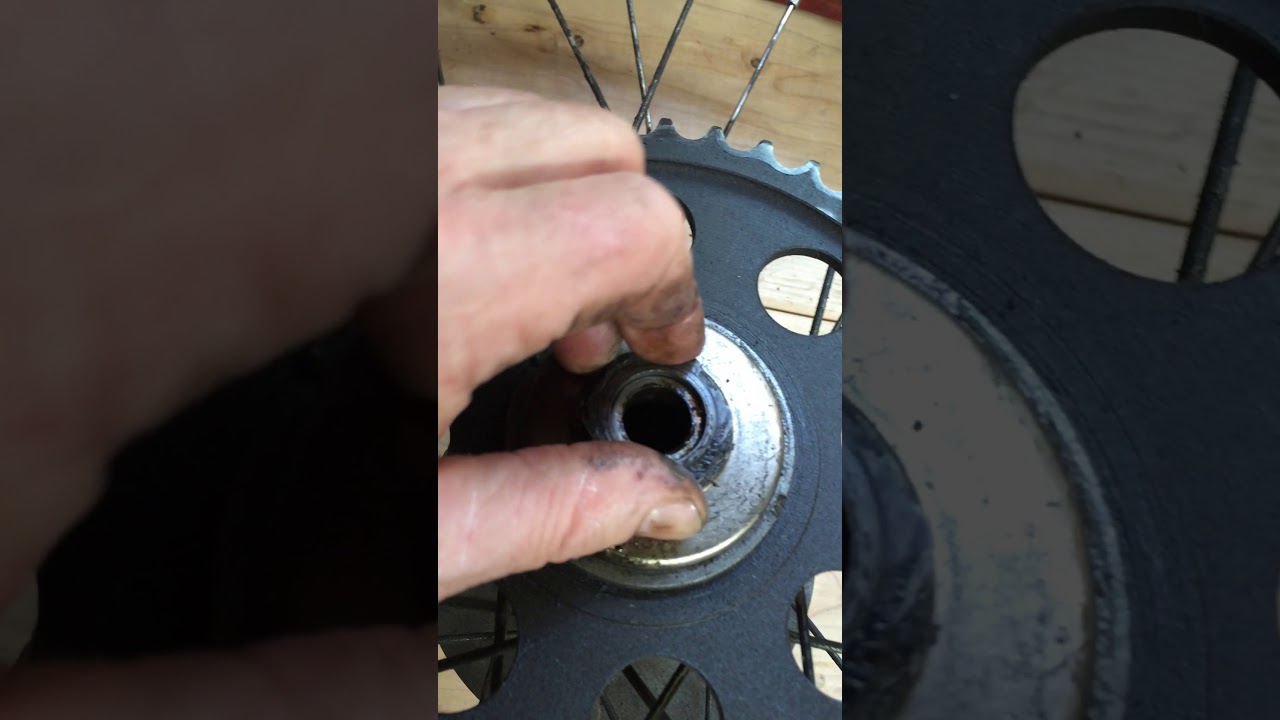

        With the rear swing are all rebushed and rebuilt, I figured I'd better address the rear wheel. It was pretty cruddy. I literally have cleaned it three times since the 2016 Cannonball, to get it looking this good.
        This is an original Indian PowerPlus rear hub. They use a loose ball, cup and cone bearing design, similar to a bicycle. They have an adjustable cone on one side so that you can adjust the bearing clearance. Many of us did this on our Schwinns and Huffy's when we were kids. After I greased and assembled it with new balls, cups, and cones two years ago I set the clearance by snugging the adjusting cone against the balls, and then backing it off a quarter turn. Every day of the 2016 Cannonball I gave the wheel a shake to see if it needed to be tightened, but it never did. I never regreased. After 4,000 hard miles I can now see that the bearing clearance has loosened up less than 1/8 of a turn. That seems reasonable.

          The wheel came apart with no surprises, and there was still a little grease on the balls.
          The cups, cones, and balls were all in great shape. I cleaned and greased them, and reassembled with the same parts.
          While I was at it I decided to throw on some new rubber. The old one probably would have made another Cannonball, but I'd rather change it now than risk having to do it on the side of the road.

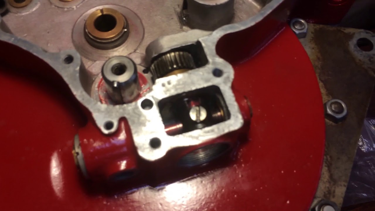

                  I remember the first time I put this little motor together I was quite nervous. I've been rebuilding engines since 1970 (I was 11 years old when I did that first one) but this one was 50 years older than anything I'd done before. These old motors are quite simple, yes, but different still. I'm not quite as nervous this time, but I will take my time anyway. So now, the first step is for three big parts to become one:
                  I set the crankshaft side play at .015 inches.
                  The first time I assembled the automatic oiler it took some research because things didn't seem to fit together right. It turns out my problem was that I was missing this little roller was that goes on the oiler crank pin. Once I found out about that, and actually found one, things fit together properly. Sometimes it's the little things that can throw you for a loop.
                  Then the plunger and crosshead go in and everything makes sense.
                  You can see the adjustment screw slot on the end of the plunger:
                  Here is a video of how the automatic oiler moves:
                  Now the timing gear, which also drives the automatic oiler, goes into the oven, and then onto the pinion shaft:
                  It gets retained by a little left handed screw and a copper washer:
                  Here the discharge check valve, inlet elbow, and caps have been installed. This time I was able to find a lead washer for the inlet elbow, which made it much easier to orient it correctly:
