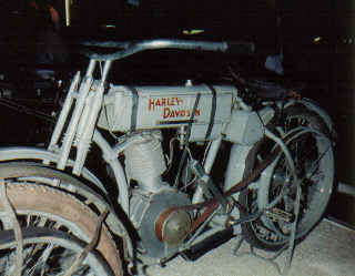

                      Henry Ford Museum
                      This reminded me that I believe I had some photos of that bike taken in 1987.
                      I will try to post them I grew up 3 miles from the Museum and Village.

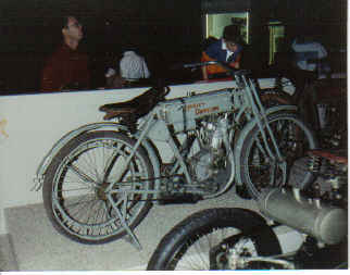

                      • Chuck#1848
                        #176
                        Other side
                        2nd photo of the Henry Ford Museum Bike

                            Thanks Chuck#1848 and Harleyson's for posting those pictures.
                            Just look at all those 1908 features we can see:
                            The gas filler is in front of the tank, not on the side like 1907 models.
                            The gas tank bottom edge is rounded, which was a new 1908 model feature.
                            The fenders are of the new-for-1908 design.
                            The muffler has an exhaust cut-out, and there is a lever and rod on the right side of the tank which operates it, which was a new 1908 model feature.
                            The front springer fork is more robust and sturdier than what we see of 1907 model springers, which were posted by Harley Creation earlier.
                            And the motor number, Serial #2278, is higher than those two excellent machines we looked at earlier in this thread, Serial # 2037, the David City Nebraska bike, and Serial # 2042, the Otis Chandler machine, both of which we all agreed were 1908 model motorcycles.
                            Without a doubt, I think we all have to agree that the Henry Ford Museum "1907" Harley Davidson motorcycle is really a 1908 model motorcycle.
                            So you see, it doesn't matter that even the Factory called it a "1907" model motorcycle, once we put it on the witness stand, nothing can change the fact of what it is.
                            The Truth is the Truth........................
