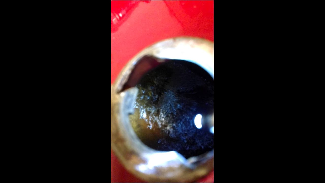

      Took her for a quick spin!!!
      Need to keep working carb, seemed to be powerless and when I stopped gas started pouring out the carb throat while running ;-) WTH!!
      Also when I pull in the garage and shut it down and closed the petcocks I heard hissing the gas in the right hand tank was bubbling? Heat from the copper gas tubes? Seems bad as the thing was acting like a gas tea pot

          BTW any idea what makes the gas Bubble? heat?

            PS: "Bumping" or flashing of fuel in a tank directly over a hot motor makes me anxious too. But it is less of an immediate safety concern than running with an overflowing carb.

              I assumed heat was the culprit on the gas line but is there a cure?

                      I wonder what's up with the gas, never seen that before. The gas tank/ gas should be pretty cool, I think - some thing is not right. Is the tank hot to the touch? Is your oil returning to the tank? Interested to see what you find is causing this, good luck.

                        No gas flooding out and not bubbling in the tank this time.
