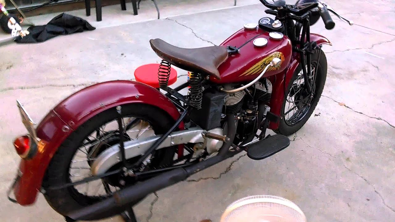

      So I got the carb off and was going to send it to V-Twin Mfg Shop in New York but after two phone calls and a few mails they said I needed a dealer to send it in? So I think I'll just rebuilt it myself and order parts from Linkertcarbs.com.
      I took it apart and it looks to be in good shape overall but the float was full of gas so I will go with a composite model.
      What I can't figure out is if I have the 1 1/4" or 1" model?
      The Carb is marked M741-1 and the side of the body has 1 MOD M and 2 5 8 stamped below that.
      The kits reference straight inlet threads vs. tapered and Harley vs. Indian and I have the straight threads.
      Any thoughts? on the size and how to tell?

        Your carb is nominally a 1" Model.
        The -1 means you have a 3/4" venturi instead of a 13/16", by my notes.
        If you intend to run the "jeep" filter, you will need a valve with tapered pipe threads (1/8"-NPT). A straight one (7/16"-27) will accept a recut with a common pipe die, as the threads per inch are the same.
        Carburetors are quite forgiving, but intake leaks are not.
        Please bubble-test as discussed at http://virtualindian.org/11techleaktest.html, and let us know how it goes,

                      I cannot view your photos well, but you do well to get rid of the soft-tipped floatvalve. Any of the metal-needle valves on the market are fine.
                      Aside from the borewear issue, please inspect for a loose venturi.
                      After thorough cleaning of body and venturi, install the venturi and hold the assembly up to light, and carefully inspect for daylight around it.
                      The manuals also do not address distortion of the manifold flange from fastener stress. It is easily dressed upon a flat stone or sheet of stick-on emery upon glass, and the aircleaner flange likes it too.
                      Your needle points may show blemishes that are easily dressed with a stone, if you have a way to spin it (attached).
                      Carefull observation will always turn up concerns not covered in the manuals, after seventy years or so.

                        Cotten et al,
                        Thanks for the great info and I an definitely a hands on guy and learning about the carb more and more. The confusion was on the various options.
                        I've cleaned it, the venturi is tight. The throttle plate does not have a key but is stamped with a 12.
                        High speed needle looks good low speed is grooved and I may just order a fresh one from Linkert.
                        I'll run rubber ducky for now and set it at 1/4 but saw your note on 7/16 so I'll need to decide I guess.
                        Did a flat sand on the flanges to get them looking good.
                        Not using a Jeep filter just an inline for now should be ok?
                        QUESTION: For the main jet I could not tell which way the holes face when it came out any need for orientation?

                          Please set the float at 1/4", as per the military Operation and Maintenance Manual.
                          You may choose to set it slightly shallower if you choose a fat gasket.
                          (No gasket was spec'd!)
                          The 7/16" setting on the blueprint is only one of several enigmatic dimensions, such as rotating the bowl to where the valve is 15/64" from the aircleaner flange. History is full of mysteries.
                          The spray nozzle need not be indexed, however there is a tradition to aim the holes forward toward the air correction slot in the venturi. Perhaps it was in a TM or a Service Shot.

                            OK!
                            Carb went back together great all clean no leaks float is working.
                            I got her running and idling great!
                            I figured out that since I had the rev's up I was on the fast idle circuit and had to slowly back off the throttle and the spark advance then turn the needle in and repeat to get is stable at slower speeds.
                            Hope to put her in gear and re-wire my brain in the morning for foot clutch and right hand shift
