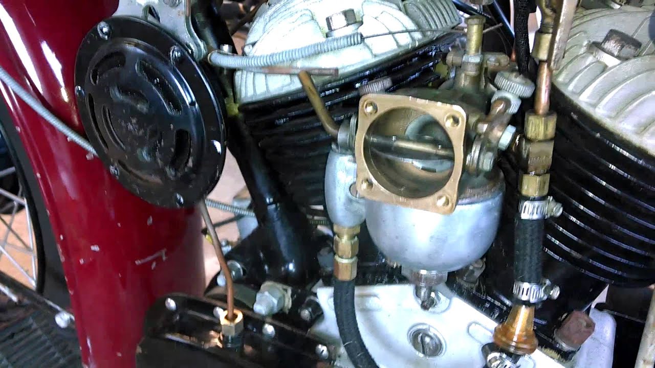

                    Ok fuel caps loose fired up two kicks idles fast
                    As I play with the throttle and spark advance it backfires and dies out. I can seem to be throttle down without spark advance full? i.e is I rotate both wrist in it should speed up both out it should idle slow right?
                    Seems to be lots of gas "splashing" out the carb as well. I set the high speed idle 1-1/2 turns out and the low speed idle 4 turns out per the riders book as a starting point.

                        • 41indian
                          • Jan 2014
                          • 62
                          Ok let is sore from kicking so I am earning this!!!
                          I pulled the fast and slow needles they look fine.
                          I ended up pulling the bowl and no signs of damage.
                          The shut of needle looks good and the float is brass
                          I set it at 1/4" from the top of the bowl is that right? I am reading that that may not be right and was for a cork float? shout it shut of lower with the brass float?
                          I can't get it to stay running unless I advance full on spark and a lot of throttle, even then you see gas coming out the carb throat now? That can't be right?
                          frustrated !!! but that's why I bought it
                          Frustrated as I had it running before I melted the wires, I set the carb back to factory preset which are supposed to be rich and made new copper core plug wires

                            Your shot's are fun to watch, hang in there. Once its running, should be full advanced, unless your trying to slow it down to the max - which is not good for the engine. Idling to slow, I mean. Always been told, keep it advanced, unless pulling a real hill or something. Then just back off a bit till you feel the engine hit a sweet spot. Not sure about the float level as far as brass, but manual says - 1/4 inch. I don't know, but on mine - I think because of worn parts. I have my needles turned way in. If I remember right my high speed was 3/4 turn out and low speed 2 turns out. With mine turned out like the manual says to start - it was way to rich. I like to run a fan on my engine when I do this work, help keep it from getting to hot. It's kind of tricky, always takes me several attempts to git it the best I can. It sounded like it was idling pretty good I thought, don't think you have intake leaks. Always better a bit rich than to lean, once you git it running the way you like. I would richen it two notches or so on the high speed just to play it safe. As long as your not blowing black smoke or back firing all over the neighborhood :-) Keep at it, usually when I git fed up and am about to throw in the towel, that's when I git it - good luck.

                              Tom thanks I ordered a new float(rubber duck)and needle/seat. I hear you on idle speed but i can back throttle off at all. Will leave advance on an see if i can dial it in.
