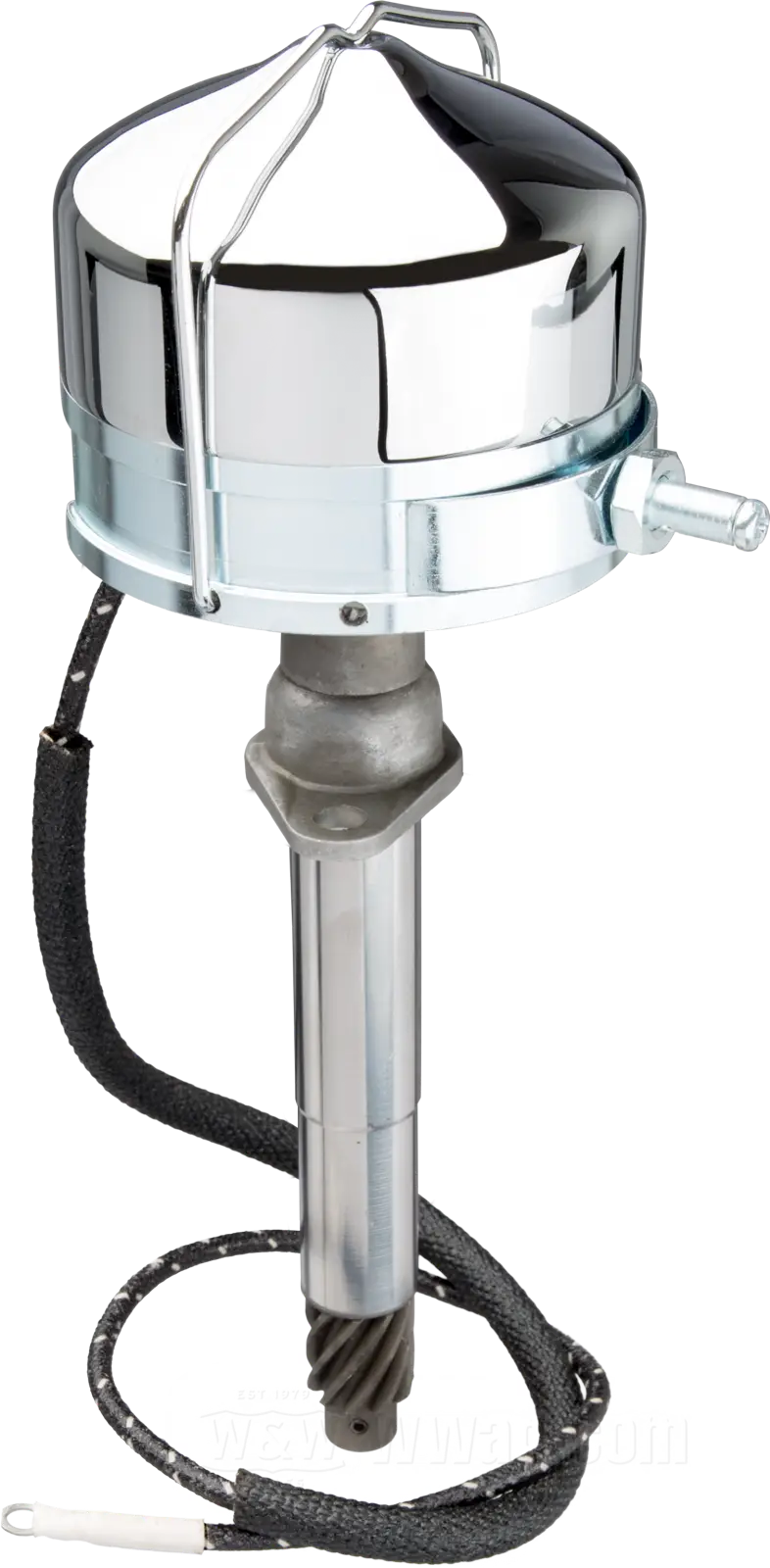

    Hi, I am intending to replace the incorrect timer with this one
    Equip your Harley with our circuit breaker assembly for OHV Big Twins (1936-1960). Replaces HD 32505-36, 32575-37.
    From reading Palmers manual, it is unclear whether this was operated manually at the timer, or through a cable to the left handlebar grip. Can anyone advise?
    Thanks, Greg

    Control cable from handlebar.
    • Rubone
      • Aug 2004
      • 4790
      All are controlled from the twist grip up until the Auto advance on the '64 Servi-Car and '65 Panhead. However, the timer you picture is not correct for '48. The '48 timer is the newer configuration with the sliding post protruding out the side. For '47-'48 they still used the early points, in '49 the points changed but outward appearance stayed the same.

          Thanks Guys, terrific response to the first of many questions - it also appears that the advance cable is held in place by a clip attached to the relay support? I'll deal with the parkerised v's chrome at a later date.

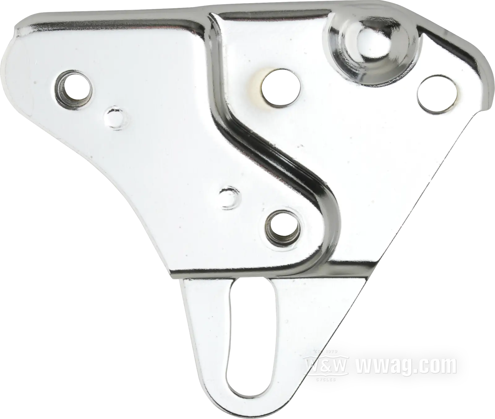

          Control Coil Bracket by Colony for 45” models (1937-1948). Steel construction, replaces HD 4162-30 & 9967.
          Paughco Delco relay bracket for Knucklehead & Panhead (1947-1964). Steel, bare finish. Replaces HD 74765-47.
