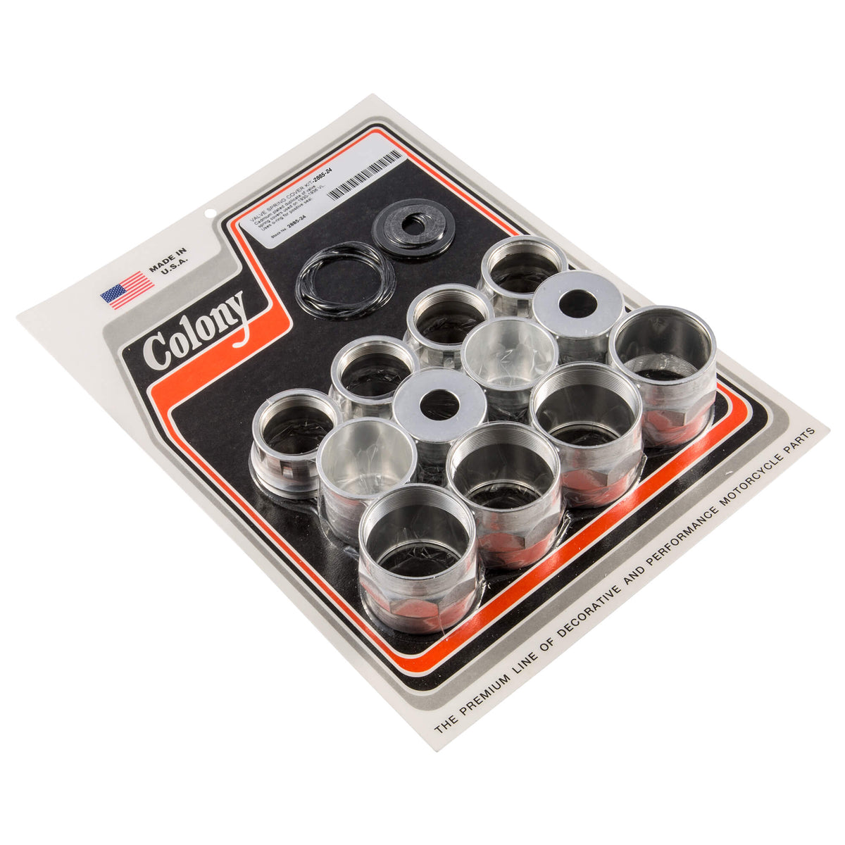

                Originally posted by Chris Haynes View Post
                Start searching eBay for better ones.
                I would love to find some OEM. Are the repros from Colony any good?

                    If you want to be correct on the valve spring covers, keep in mind that the originals were cad plated and not zinc plated.
                      I have a set of the Colony repros, not yet installed, and comparing them to my originals they certainly look the same. I just need to get them Cad plated.
                      The threads on the originals are stripped so I needed replacements. Replicant Metals sell them also.
                        Thanks Peter. I found some for sale here and they say they are Cad plated?

                          #27
                          That's a good deal from low brow customs. Yes, cadmium is correct.
                                https://www.lowbrowcustoms.com/2885-...l-1930-36.html
                                Despite what they say they may be Zinc. You'll see a yellowish, or bluish, tinge if they're zinc. That is a good price. I think I got mine from them. Or it may have been Flatland.
