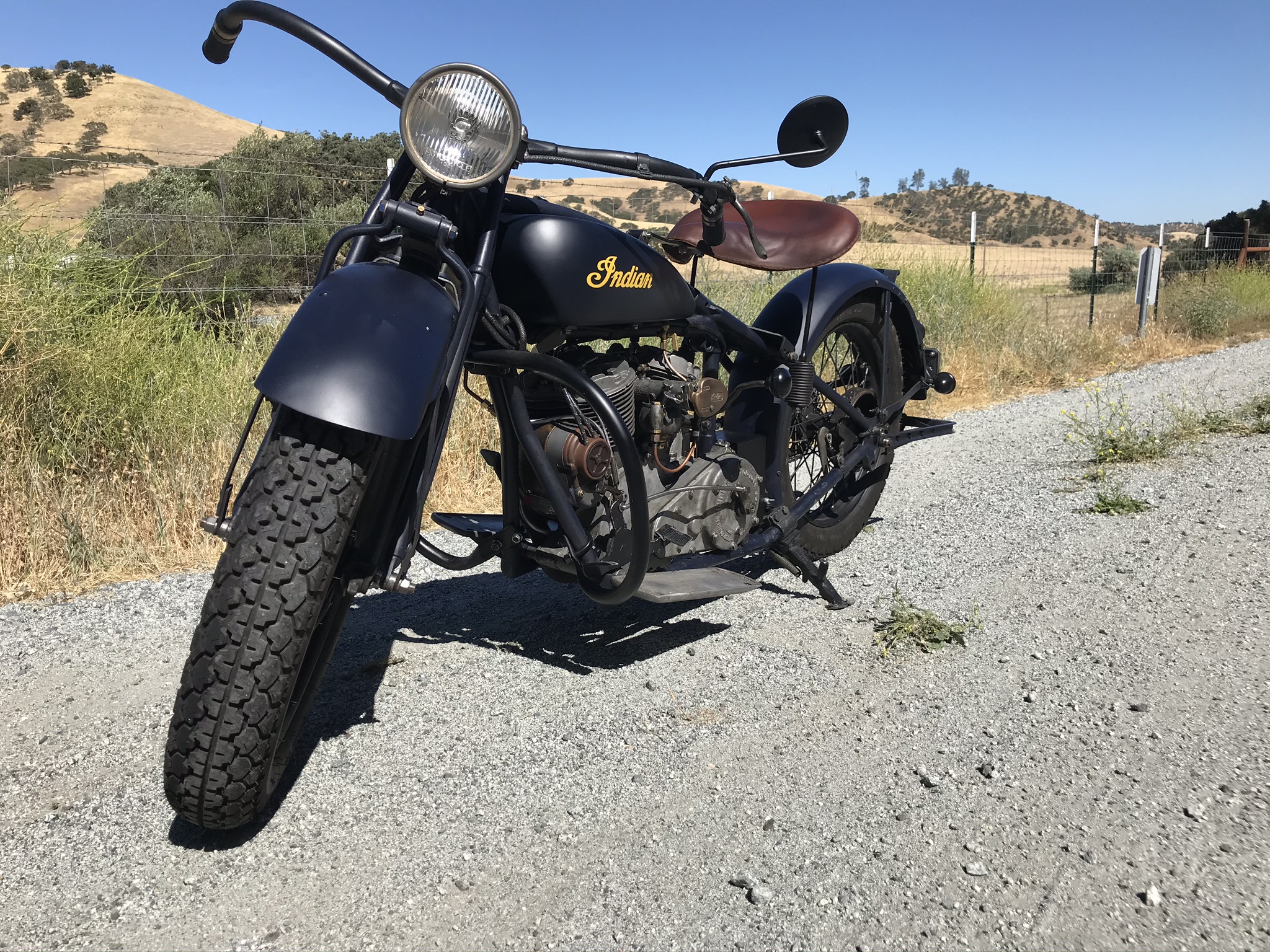

                  I got in a couple of 20 mile runs on Saturday, mostly to get the oil meter dialed in and check the carb settings and spark plugs. Today we went on a long 130 mile round trip ride to pinnacles national park. We had a nice picnic lunch and met a bunch of nice people who all wanted to know how old the bike is. People don’t get to see a 90 year old bike very often.
                  Here’s a nice pic from the side of the road up to the park.
