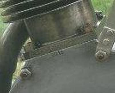

        It appears that there is a number stamped in the case just below the cylinder. I took the photo from eBay and crop it and blew it up. Its hard to read, but the last 3 digits seem to be 015. The first could be a 2 or a 3 or who knows what.
        I'l try to attach a copy of the enlarged picture.
        Dave

          Excellent job! There does seem to be a serial number on this bike and no mistake. A 1908 number would probably fall between 2000(?) to 2500.

                That's all I got. The rest is a secret I guess.... From Dave's picture the number looks to be 2015 or 2016.
                • Chuck#1848
                  #83
                  It looks to be a "6" at the end
                    #84
                    Sure looks like 2016 to me..........Early '08........ I'm leaning toward Herb's thinking on the used thing. I'm thinking it's a resto of some sort in disguise........

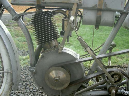

                        Here's my latest find, looks to me to be a later model badged as a "1906". Let's hear what the expert have to say about this one....from the AMA web page...here's the link......
                          #87
                            #88
                            picture 2
                              #89
                              Well Louie.........Herb and Earl will put you on the right path, but I'm thinking it's '08 or later. Herb's comments above will confirm that. The AMA site is also still following the traditional story on the origins of H-D. I think that it's very historically important to find the truth. Herb's gone a long way to putting everyone on the right track. This thread is absolutely wonderful, I've learned a lot already.........

                                I've been told that the motor in this machine is an original Harley. Or at least the cases are.
                                Looking at the motor I count 8 studs holding the crankcases together. I'm not aware of any 1906 period photos showing an 8-stud motor in a 1906 model motorcycle. The earliest period photos that I'm aware of that show an 8-stud motor, have it appear in a 1907 model motorcycle.
                                Herb may wish to comment on this........
                                Does ANYONE have any other information to add to this???
                                We have compared the chassis features of two excellent original Harleys, in Serial # 2037 and Serial # 2042. So we have two known original examples of 1908 motors. If the motor in this "1906" machine could be compared with the two known 1908 motors, that may help date the motor's vintage. If there are definite differences in the castings, then the motor may be from a different model year. These differences probably would not be visible to photograph comparison. I've been told by some, that motors in the 18xx range have some definite differences. So even by knowing the serial number of this original motor, we may be able to give it a probable model year date, but the earliest I think it could be is from 1907.
                                The chassis of this "1906" machine shows a mix of characteristics; smooth fenders ala 1906, but later 1908 style tank. I think we shouldn't concentrate too much right now on the chassis, since there are so many reproduction pieces around.
