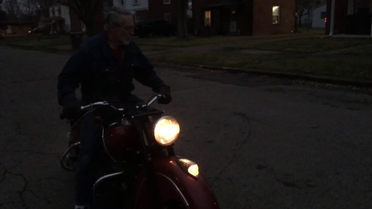

                Got it going after 26 years and 3 months.
                Thanks to everyone who offered advice.
                Larry

                  Glad to see you on the Indian, Larry; quite a satisfying feeling, isn't it? Thanks for the video post and update.
                  AMCA # 3233

                    Where's that doggone "Like" button when you need it. Congratulations Larry!

                              Nice! And I especially liked the glow of your fender lamp in the video...you don't see that very often!
                                • 6020
                                #30
                                Funny that you mention the Indian head fender light, Harry. My childhood memory is of a neighbor that had an early '50s Pontiac that had a light-up Indian head hood ornament. I don't think I'm alone in thinking that cars, and motorcycles of the past did a much better job of creating a mystique, and aesthetic for industrial design. I'm happy for Larry that his Indian is giving him joy after so many years.
