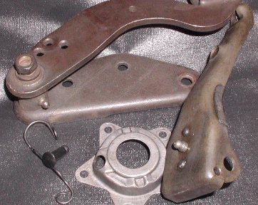

    The real thing varied widely, as original parts show clearly in the attachment.
    If all the parkerizing on a machine matches, it might as well have been rattle-can'd.

              Mismatched color will even occur on the same object, a perfect example is the clutch operating arm in the picture that Tom posted above. If that piece was thoroughly bead blasted, degreased and parkerized as a unit there would be several different colors on the same piece; the body is stamped cold rolled steel and would probably be a dark shade of grey, the rivets may be softer and come out a darker color, the weld material is a different alloy altogether, no telling what color it would be, and finally the grease zerk was more than likely cad or zinc plated so it would probably look spotty depended on how well it was bead blasted.
