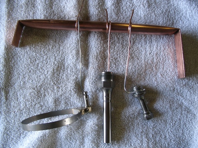

    Cad plating step 1, the parts should be absolutely clean bare metal and look almost as if they were already plated.

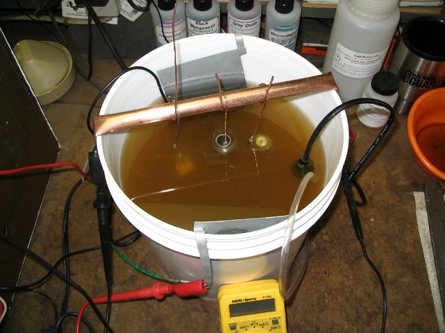

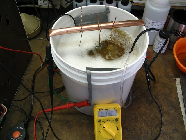

      cad plating step 3. unlike checking for leaks on an intake manifold we want bubbles here. first pic shows parts suspended in plating take before the current is turned on. second pic show what happens when you have TOO MUCH current, fast and furious plating and lots of bubbles; you get flakey lumpy plating results from something like this. Best is just a light fizzing around the parts. takes about 15-20 minutes.
      • #18
        cad plating step 3. before the current is turned on

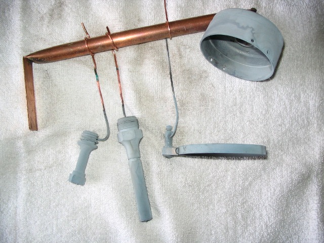

          cad plating step 4. When the parts come out of the plating tank and are rinsed and dried they will have a dull chalky appearance. Hand buffing with 0000 steel wool will shine them right up

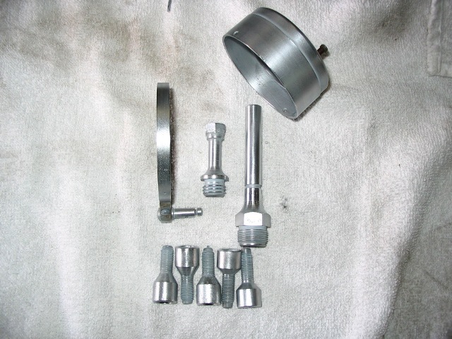

            cad plating final results. After a very light buffing with extra fine steel wool (0000) and applying wax or other protective coating the parts are ready to install. Start to finish you could do a batch of parts like this in about 2 hours.

                Cad plating, unlike chrome or nickel, is a very low voltage, low amperage operation. You can see the voltmeter in one of the pics, its plating just fine at 1.48 volts. Chemicals are not any more hazardous than most common household cleaners and storage is easy, the plastic pail that comes with the kit has a snap on lid that seals it up air tight. It is a very low risk procedure.
