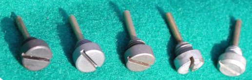

                            If all of the cadmium (or all of the parkerizing) on a machine matches, it should be a fault.
                            Attached is a pic of a selection of NOS cad floatbowl pivot nuts, straight out of cosmoline. Not included are the completely bare ones from the same lot.
