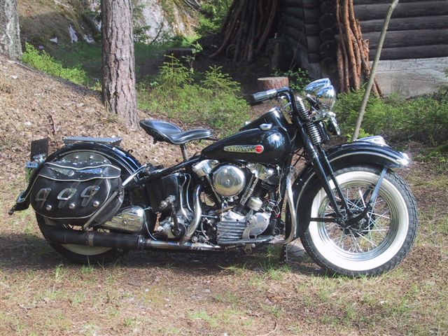

                          ps nice picture of your 47

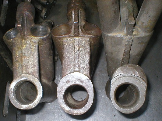

                            I have a few original necks here and can try to give a visual reference on how to pick a neck by simply looking at it.
                            The neck on the left is a 1940 25 degree neck
                            middle neck is 1941- early 46
                            Right neck is a Bullneck "that has seen happier days...or should that be... Happy Days"
                            Even though the Bullneck has been hacked by a chopper jockey, you can see that the metal behind the bore "even behind the machined section" is substanstial compared to the 41-46 frame.
                            Bruce writes in the "How to" book that there is another fully machined off type of bullneck. I have not seen one of these but it would still have a big machined off area behind the bore. The cables, tanks and springer can make it hard to measure but I can identify a neck by looking at it.
                            Regards Steve
