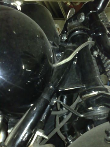

    Good pix! You do not have a late '47 neck forging? It is such a mess to measure anything when the bike is in one piece. I tried to measure the lower reinforcement (profile like the base of an I-bar). It is 63 mm. I took a picture of the neck at my winter storage. I only had my phone with me so pix are not the best and it was a tight spot to get my hand down between the bikes.
    If you cannot make anything out of the small size in this site, I can email you them in larger format. Also the '46 UL is in one piece, so I cannot tell which Bullneck it has until I start working on it one of these years.
    Fiskis
    • framemaker
      Hi Fiskis.
      This looks like the Double U frame used in the last run of 1947. If you look closely in the big triangular gusset on the right side of the neck you should see a mark like this UU on a bit of an angle. The U's can be a bit faint and blasting can obliterate them

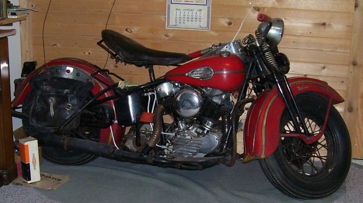

        Here is a 1946
        with the 1945- early 46 frame, inline springer.
        37XX ser. no. 2 years ago, I had a 46 with the
        Bullneck frame, and offset springer. It was sn. range
        4500 as for my earlier post, I sould have "said"
        there are always, exceptions.
        All the "original paint" 46s, I have looked at over the years
        seem to have changed from early 46 frame, inline springers
        to bullneck frame, offset springer, widebrace fenders.
        from 4200 to 4400 serial nos. ( I am no authority, just my
        observations) Again "always exceptions" LJH

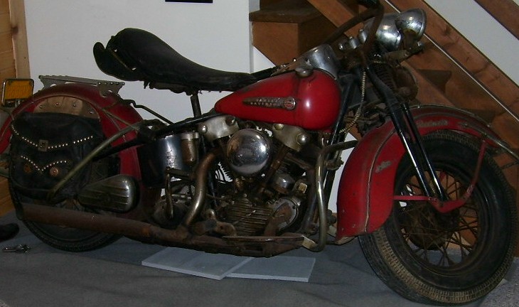

        • LJH
          Here is a 1947
          midyear frame (after the bullneck) offset springer,
          narrow brace fenders (palmers book says- early)
          45XX ser. no Bought from original owners son
          I have never seen that frame before 6000 sn.
          and those bikes had widebrace fenders
          so much for the sn. Identifcations
          (always exceptions)
          LJH
