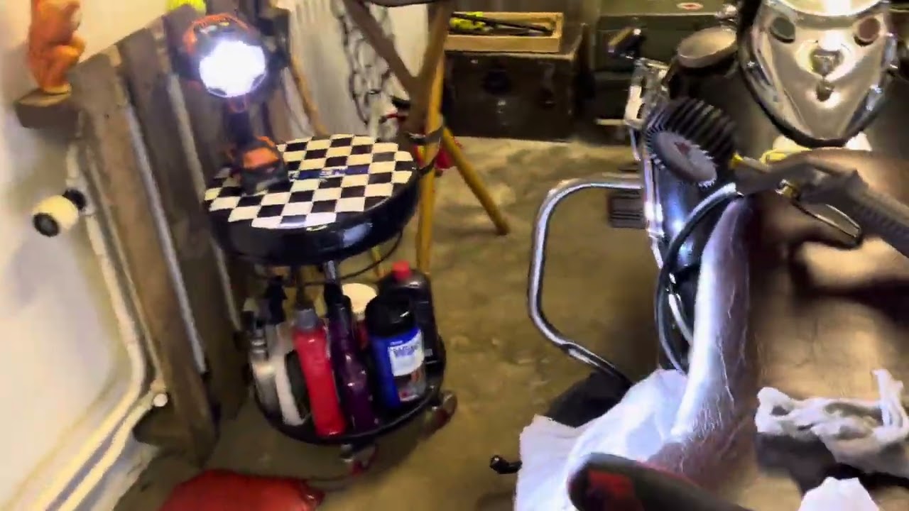

            I have no idea what's going on in your video, Ed!
            All that foam makes it look like it is leaking everywhere,
            And the sound suggests it isn't a constant air supply.

                Sorry for the poor video then. There is no bubbles at all on the foam when using constant air flow or neither in this video. The foam is a bit tick to help to identify leaks.
                it doesn’t hurt to make a compression test as well…I will do that.
                  Gadfly from the Dumpster
                  • 8243
                  Please thin your soap solution, Ed,...
                  Or you won't be able to see bubbles form.
                  The tiniest leaks take a half a minute to form 'blisters' of foam.
                  These examples show porosities can appear anywhere, not just at the nuts and seals.
                  ..Cotten

                  ..after the manifold leak test. For that I have a device that allows me to pump air inside the cylinders with the help of a small compressor or bicycle air pump.
                  You must have a regulated, constant air supply, Ed!
                  The natural leakage past the intake valve guides alone is orders of magnitude larger than the leaks we seek. Tire pumps, air mattress pumps, and shop vacs (if you can believe somebody tried) are futile... .. ..

                            Hello Cotten, find attached video clip showing the manifold leak test that I did with a light foam.
