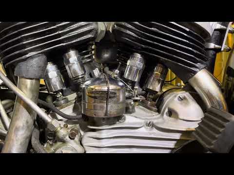

    I am adding a video clip showing how is the engine working after this incident, I think everything sounds normal but would appreciate to get your say,

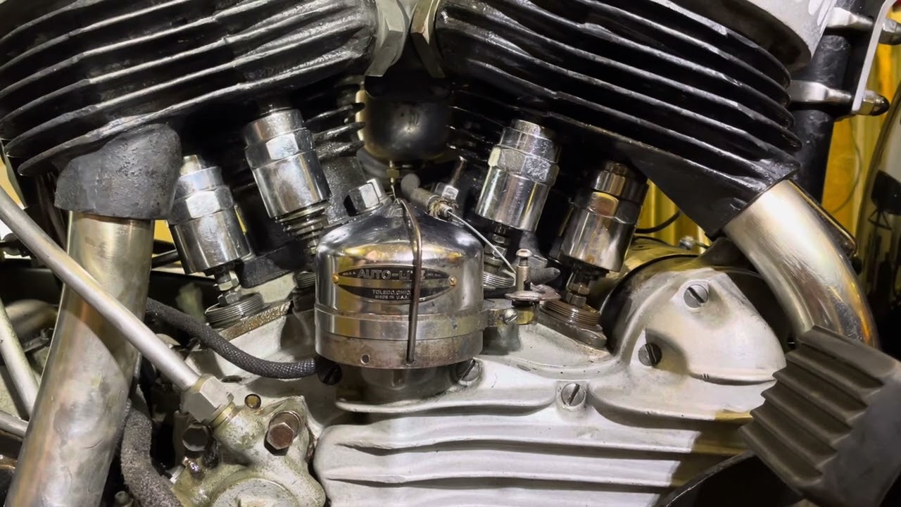

                1) What do the plugs look like? I think they look good, see pictures below, but I replaced them with a brand new ones and no progress

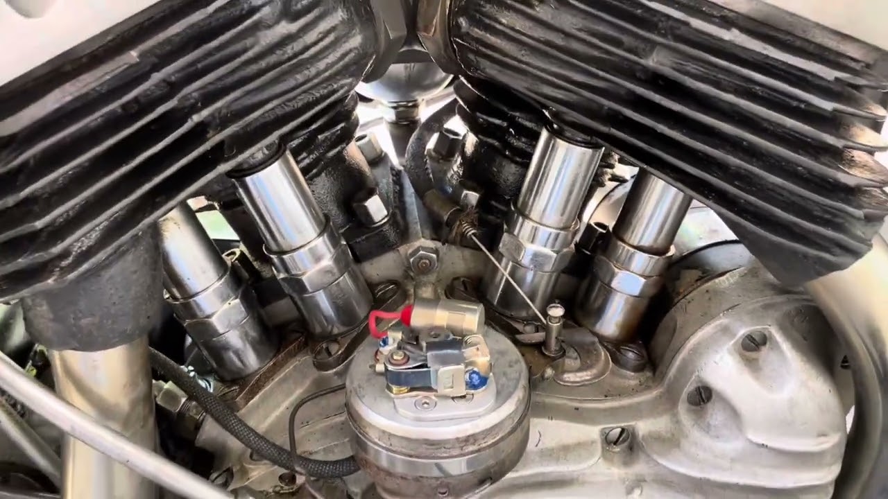

                2) I removed the spark plugs and uncovered the valves, please check the attached video clip. All seems to be good but please comment.
                3) The pipes are not discolored cylinder paint is good as it was before, please check on the pictures.
