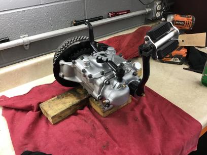

                              970D4E2F-B38D-4D25-BBB2-4977F88012B8.jpgtook me a while to figure out how to make this work
                              Bottom left and right are homade stamps. On retainer is stamped washer. I just finished another VL Tranny today,same issues. Hope this helps. Ray

                                #105
                                Thanks Ray,
                                Very much appreciated.
