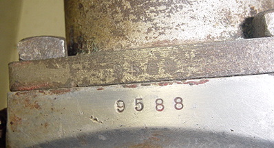

                        belly numbers
                        belly numbers. also, it is stamped in the mag drive. I count 5 places it says 9588.
