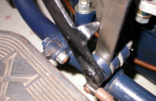

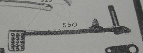

    Interesting that your bike has a separate bracket Ken. My bike has the bracket for the lever as an integral part of the pedal and the parts books implies the same (see photos below of the parts book pedal and my klunker's pedal). rickeieio, I don't know what brochure Dale showed you, but in terms of which DeLuxe brochures apply to which year bikes, we just went back and forth on this over on the Henderson site:

      Here's the picture of my klunker's pedal ... Perry

          Perry , you are right but my parts book lists two clutch pedals
          K-551 and K-551A , the former listed as ''Clutch pedal and Fulcrum Bolt Assembly'' and with the A suffix ''Clutch Pedal for Machines with Reverse'' so perhaps mine had reverse at some time as does rickeieio's , so Rick a bolted bracket would be best just in case you wish to attach a chair and make use of reverse .

              Ken - you're absolutely right! I didn't know there were two different pedals! The more I learn the less I know! ... Perry
