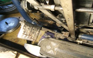

                        I'm a bit confused about the idea of disconnecting the reverse rod. Is the clutch tied into the lever?

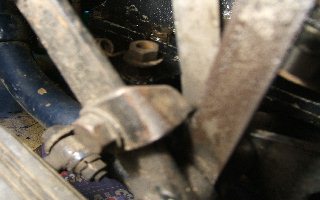

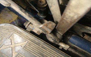

                          Hi rickeieio , the reason the title may say '28 is the bike was a late model and didn't sell till early '28 and therefore registered as a '28 , the reverse lever (the outer one) as yours is set up is aslo used as a clutch lever when the reverse is not connected , most solo machined would use this as the hand clutch lever but was used as reverse when a sidecar is attached , when in clutch lever mode the rod from this lever to the reverse arm from the gearbox is disconected , and an ''L'' shaped bracket bolted onto the foot clutch pedal so when the large hand lever is moved forward this ''L'' bracket catches the lever and depresses the foot pedal operating the clutch , I will try and attach a couple of pics of the pedal bracket , the only thing that would enhance this very lovely bike is miles , happy riding , Ken

                            rickeieio , another pic , sorry do not know how to do multiple pics on here ?????????????? anyone ???? , Ken

                              and lastly , but if you want more , just ask , Ken

                                Thanks for the pics. Now I understand how that would be done.
