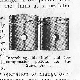

Interesting 50/50 mix. That's the same mix Excelsior recommended (circa 1927/28) for the Super Sport Super/X. Here's a quote from the owner's handbook:It goes on to admonish the reader that it must be 90% pure and not the inferior Benzol sold at filling stations ... PerryThe very best fuel we have found for the high compression Super Sport is a combination of half aviation gasoline and half 90% pure "Waterclear" Benzol.
I have no idea what the compression ratio is but the Super Sport was shipped with two sets of pistons (see attached scan). You were expected to run the 50/50 mix when you put in the high compression ones. To facilitate swapping, the piston rings are in the same location on the high and low compression pistons. The Super Sport was quite a different machine than the regular Super ... PerryAttached Files
