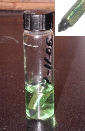

      And the "fuel" alone is corrosive of brass, as shown on the swollen viton needle in the attachment.
      Add the spectre of illegal dumping, and there is no way of telling what we will find in our floatbowls.

            "Rubber" needles shouldn't change dimension in the first place. It makes float setting a real pain.
            And every time you fill up on a different blend, your volumetric efficiency changes.
            Once again, it isn't that any particular sealer, compound, or "rubber" is bad,...its the digestive fuel, folks.
