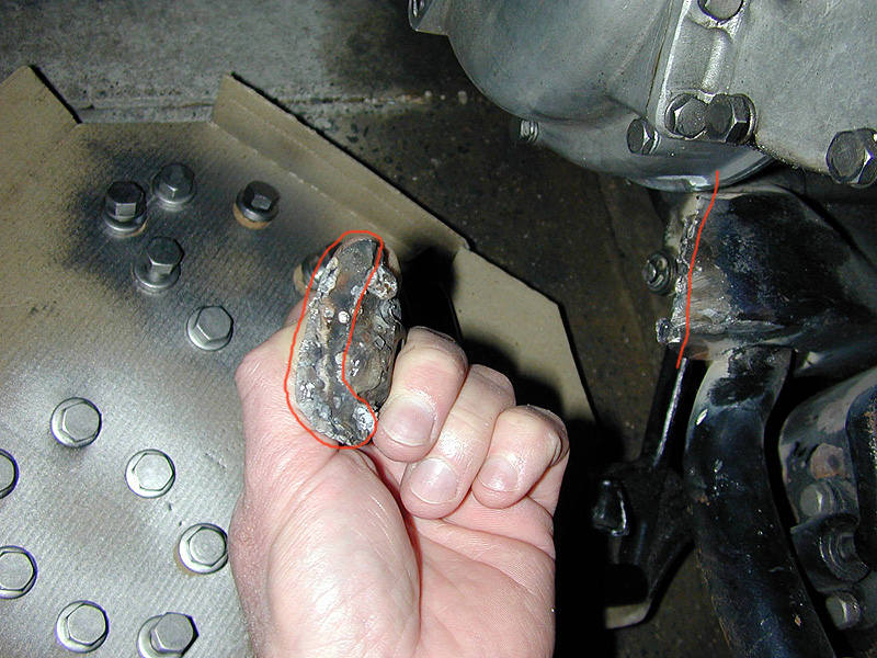

            As embarassing as it is to see the horrid weld I did. Here it is- have a good laugh.
            I believe that the lug is sand cast. The side stand arm seems to be drop forged.
              here it is. I need help.
              I think you can clearly see I got little to no contact on the bottom.

                            You got no penetration into the mating parts. You might do a spark test to determine the material you are working with. A good welding book has the spark patterns in it to help you.
                            First clean the metal which it looks like you did. I've had the best luck with a carbide burr as it leaves no contamination in the weld area like a grinding wheel can. Make a deep V so you can penetrate through the root of the weld from both sides. The trick here is to be able to hold the two halves rigid while you do your welding. Then consult a welding handbook or a welding shop for the correct current for your rod. Tig would be my first choice followed by Mig and then a DC welder if possible with an AC unit as last choice. 7018 rod would be the best for stick welding followed by 6011 or 6013 (deep penetration). You can use 7014 or 7024 if you don't want to go with 7018 for the rest of the weld as they weld easy and fill quickly. Do a pass first on one side and then on the other to minimize warpage with a cooling period between passes to make it easier for you to work in the area of the weld. Hope this helps. Your profile says you are in the northwest. If this is so look me up and possibly you are close enough to consult in person. The neighbor is about to graduate from welding school and does beautiful welds.
