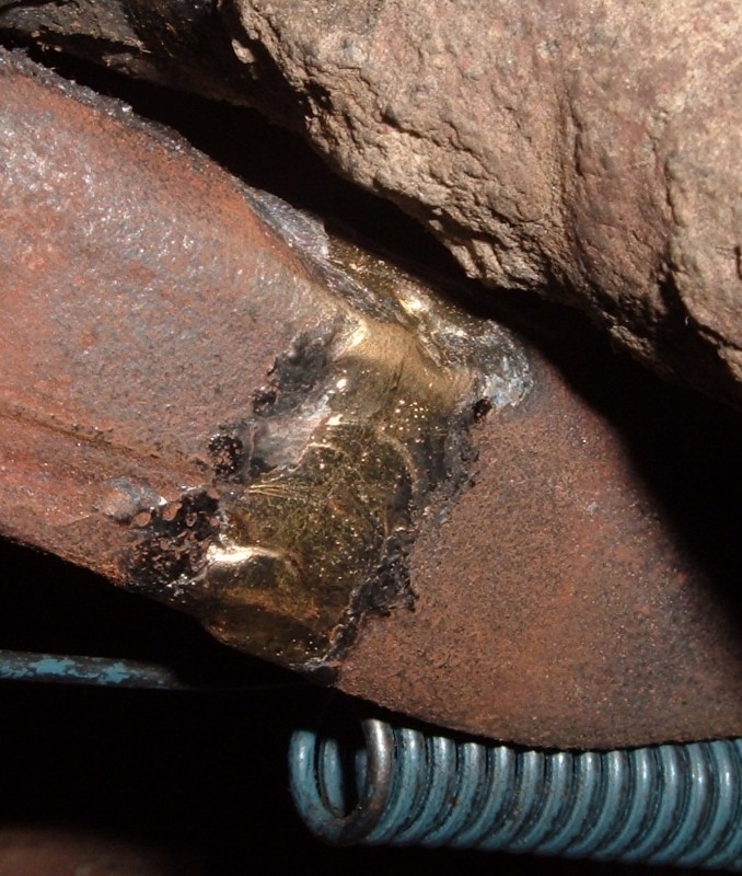

      I would make the hollow axle of High Stress tool steel such as S7 and have it heat treated to the same hardness as the broken one. As for the kickstand I will stand behind brazing as Tried and True for me

            Kojack--it would not surprise me if some frame lugs and necks were steel forgings rather than castings. If so, they would be readily weldable. In the situation with my '52 Chief kickstand, I decided to find out what it was before I attempted to fix it. As it turned out to be malleable cast iron, I knew that brazing would be the best option and that is how I proceeded.
