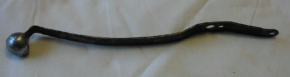

        Partshunt,
        Have the attached lever, not sure if it is an early clutch or gear lever (2 holes + mounting shaft hole ??), but the curve of the lever clashes with the curved side of a 25 teardrop tank.
        Looking to swap for a good '25 gear shift lever.
        Smarty
