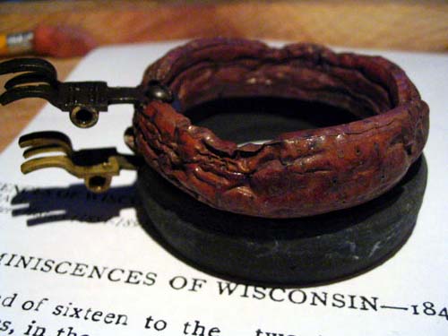

    10. When I got the bowl off, I discovered an ugly, shriveled-up, old dead cork float inside. When tested in water it seemed to work okay, but then I got to hunting around in my old junk and found this nice black foam(?) late model H-D float. It was in a Big Twin carb that somebody had chopper-chromed the bowl on and put in a brand-new float and then overdosed or something. Now it's inside the carb on Mr. Servi-Car. Nicest thing on the whole machine and it makes him feel good too! Here's the old dead float sitting on top of the new good one.
      "and then overdosed or something"? I hate to hear stuff like that when people give up hope, or succumb to addiction.
      Old cork float looks typical. Shellac or varnish -Punctured, swollen, dried up.
      Cottons foam floats are great. Very delicate things.
        This black float I found seems to be of a dense foam material too. Seems like type you could get from H-D in the 1970s yet.

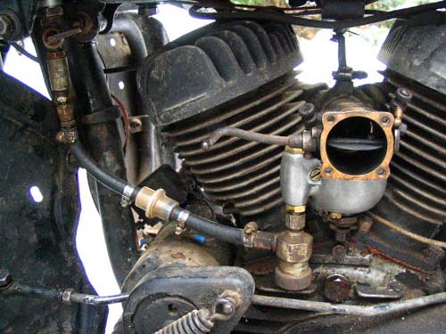

          11. With all that rust in the gas tank I figured that adding a filter to the fuel line would be cheap insurance. So I rummaged around some more and found this old plastic job. Okay, I'd prefer the orig. metal line, but if you look close you'll see there's already a non-H-D petcock on the gas-tank.

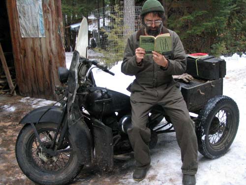

            12. First test ride on a cold early January day. Got about half way out when engine started missing like crazy. So I turned around and beat it for home. Seemed to run better with the choke partly on.

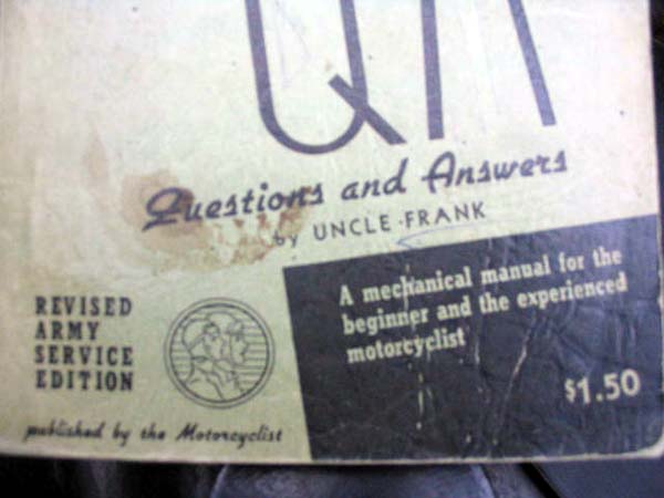

              13. Back home again and after it warmed up a little I figured that the carb needed adjusting as I had taken the needles out and no doubt messed them up. So I got out "Questions & Answers" by good old "Uncle Frank" to refresh myself on the orig. carb settings.
                14. If you aren't familiar with or own a copy of "Questions and Answers" by Uncle Frank, you really should glom onto one. It has TONS of useful information about Harleys and Indians and valuable charts and tables on motorcycle stuff in general. This is an original "Army Service Edition" but there were several others plus modern reprints. Can't recall the year it first came out, but I'd guess like 1938 or 1939 maybe? I sort of think that Bill Knuth had something to do with its publication.
                Quiz time: Anybody know who "Uncle Frank" really was??????????

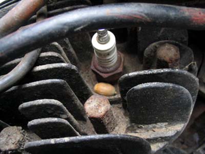

                  15. Hey what's that acorn doing down there?
                  Not only was the carb badly in need of adjustment, but I found the sparkplug wires jumping around loose, plus several years of red squirrels and other critters messing with my trike. So I adjusted the carb, crimped the plug ends better, and cleaned the plugs. Good enough!

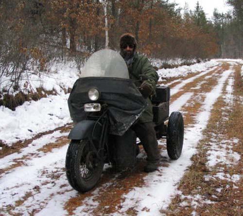

                    16. Since it snowed before I took Mr. Servi-Car out again (and I don't like being seen) I donned my winter camo so I wouldn't be spotted. Notice how I blend in almost perfectly with the woods. That keeps the EPA off my butt for all those inperfectly combusted hydro-carbons the old 45 side-valve is spewing into the environment.

                      All that snow! Looks like you are having some fun Herb. We have a little snow on N. facing slopes, but otherwise gone. I live in the LaCrosse, WI area. I got a hundred miles on the pan today, 40-50 degrees. Would have been more, but harrassment and tavern stops got in the way. What a treat to ride around in relative comfort at the end of January. Herb, I am curious, do you have a helper operating the camera or do you have the camera on a stump and timer function very well managed? I really do not think it matters what you wear for camo, nobody will notice you, they will all be looking at the machine.

                        cool looking rig harley...being as i suggested the donut thing ,ihave to retract that after seeing that your backyard looks like mine.seems to be plenty of woods .i know it may be a little late and im not sure when your deer season ended,but............you need a nice 10 point 200lb. whitetail on your scooter while the donut is being performed. you have the camo thing down so im sure the wardens wont see ya!

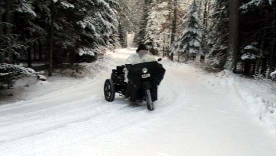

                                18. This is not a turn but coming straight down the trail with the tail section swinging side-to-side. Mr. Servi-Car gives you oscillating motion in the back just by tweaking the handlebar a little bit which cranks the entire frame section on the neck. The front end goes straight ahead while the back increasingly fishtails as wildly as you desire. Looks and feels crazy and occasionally you will spin out so beware.
