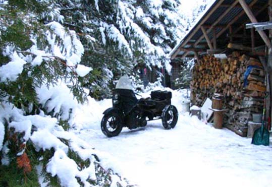

    1. Old Mr. Servi-Car just rolled out of the shed. Put in a charged ni-cad wet cell battery, fresh oil, gas, added kick, and NOTHING. Rusted plugged gastank and a gummy carb turned out to be the culprits.

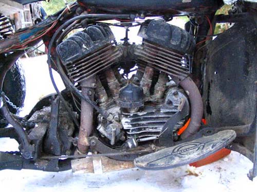

    2. Harley-Davidson's venerable 45-inch sidevalve engine. Introduced in 1929, it stayed in production until 1973, or was that 1974? This baby is a 1942 WLA army engine. Note the "cool" chopper pipes. The frame is also hacked of speedo mounts and notice the chopper seat mount just above the seat-tube. That stuff is NOT my doing.

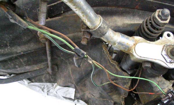

        4. Who wired this thing anyway?

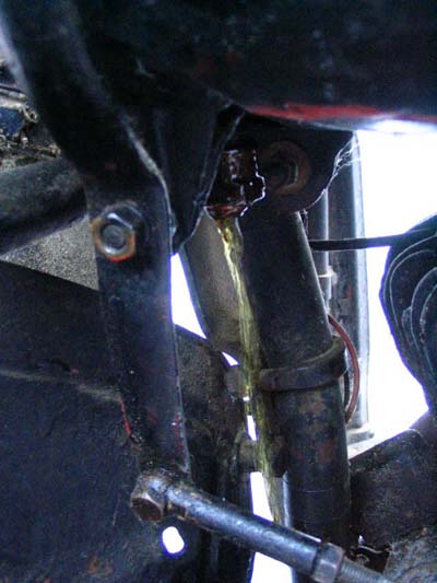

          5. Draining the bad old gas. More like varnish and that's what it smelled like. Also TONS of rust in the tank. Had to stick a wire up thru the fitting to get the old gas to drain at all it was so badly plugged up. Good lesson not to let your machine sit without either draining the gas or using fuel stabilizer.

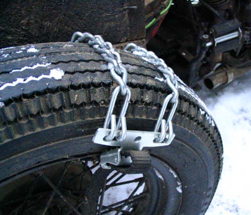

                          7. Of course when you don't want to slide around but need good dig-in power you throw on your tire chains! You'll notice this Servi-Car has the old motorcycle wheels and tires that are not much better than slicks. You spend half your life with one wheel spinning as you try to get forward momentum going, but that's fun too. Chains become necessary when the snow gets more than a few inches deep. I find this type to be easy to put on and take off and they work well too. I wonder how the snow riding would be if you had the later car rims on back and put snow tires on them?

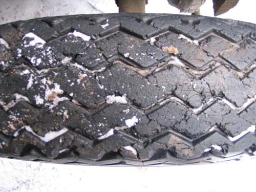

                            8. Speaking of slicks, this cracked ratty old Firestone(?) tire was on Servi-Car's wheel when I got it back in the 1980s and it's been on the machine ever since. Whatever inner tube is in this thing it almost seems immortal. Maybe one of those double-wall tubes mentioned on another thread?
