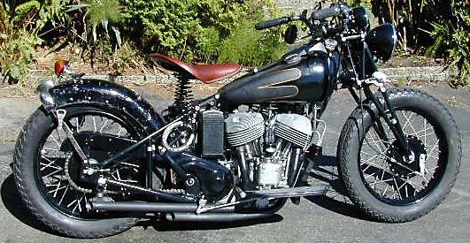

Fires on prime, no run- what was float level set w/ foam?
  • #16
    Chug, chug, chug, chug, dies.
    I haven't checked tappets. Valves need lapping for sure. Tried the up-right center kicking. Idle passage clear. Timeing checked -it's good.
    It's like it's just not ****ing up the gas? Any suggestions? I've got the throttle wide open.
    I want to try everything before pulling the barrel. IT SHOULD RUN! This is killing me. I'm stumped. Help me get this thing running!

      By the way thanks for the pic looks like a lady killer to me!!

        No -zee gas is a flowin. I have period HD filter on it (no wise cracks) it was free and what most guys used at the time. Bowl is full.
        I'm feeling the 20lb compression diff. is enough to upset the balance of nature with this engine. Will try to check tappets tonight. All though I usually do a couple rotations and am very careful with setting them.

          I am wondering about your ignition timing procedure?
          Revolve motor until both valves on the the front cylinder are closed. (Compression Stroke) With piston 3/8" BEFORE TOP of stroke ignition points should just be starting to open with the spark control fully advanced.
          I had a Chief once that would start after setting the timing then quit until I reset the timing. A pin in the distributer drive gear was sheared allowing the timing to slip.

              Yup - that's method used. little more retarded. and thanks.
              Both valves closed on comp stroke. Exh valve front open.

              The vacuum is not pulling new gas into the engine. This is so primative a system I can't believe I'm having these problems. I'll unscrew highspeed needle some more. Try some B7HS plugs.
              Bike ran for 10sec. when I tilted let the prim flow into manifold. But at full throttle it should pick-up.
              • #22
                OK, my inexperience is clearly shown now. I was wondering why the plugs were getting fouled so quickly all day. Too rich. So it dawns on me like a ton of bricks that the old style choke "moves the needle" So as the bike fires on prime you should immediately move the choke up a couple of notches. Obvious to some - but not for the new guy. ME.
                So after if figured that out. The thing fires up tonight like the unholy beast that it is with straight pipes. Engine sounds great. Window pains rattle, babies cry, fuddy dud neighbours scowl, my cop neighbours applaud (they all have hot rods and/or muscle cars). I need some baffles in there. My ears are still ringing.
                I've set the idle (sort of), and adjusted the clutch. Did a little zip up and down the street. Quite a proud moment for me. One of lifes little mile stones. Now I've identified the oil leaks and can get down to business. Redline oil in the primary/trans helps alot. Its red.
                Oil return shot up about a foot when I took the cap off. So thats working. Pipe redirected forward, breather at back.
