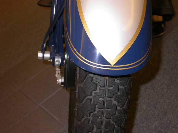

      Thanks Perry, but what about the spacers for the front wheel? Do they sit between fender strud and fork or between fender strud and nut?
        Hopefully this answers your question ... Perry
          Front fender & axle
          Perry, Thank you very much. Now I know how it fits together and I have learned that most of the 4s around are abviously not correct in this regard.
