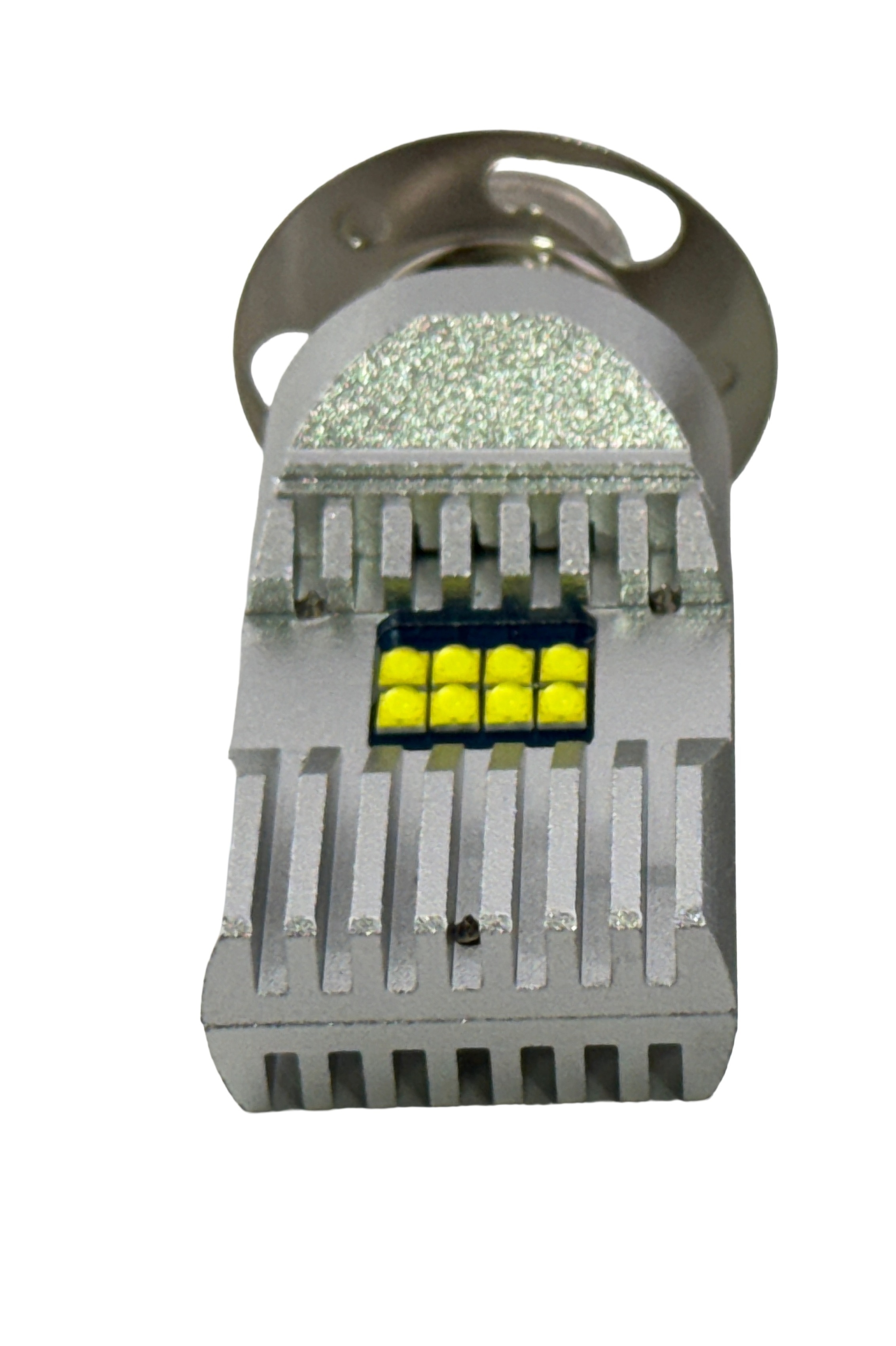

        Howdy sir,
        Yes, assume you’re looking for 6 volt? Have been using LED’s since they first became available and this new generation is phenomenal. No fans in this application, not bulky and tolerant of voltage spikes which can occur on machines still using 3 brush generators and cutouts. I have 7 of the version below in use. The 3 eared bayonet base can be a bit fiddly to install.
        Rebaydo P15D-30 LED Headlight bulb. Works both positive chassis and negative chassis. Operates voltage from 5 to 30 Volts full brightness at any voltage in 62528
                    • PRG
                      • Nov 2006
                      • 616
                      Howdy sir,
                      The bulb depicted above is the exact same one as in my initial response with the link to www.ledlight.com which provides more detail. Again, as this technology has evolved they have improved exponentially in durability, heat rejection, voltage variance tolerance and construction quality. This is another application wherein all 6 bulbs sourced from the same vendor, plug and play except HD long neck spots need to be converted to Indian spot reflectors to accept these hi/low headlight bulbs.
