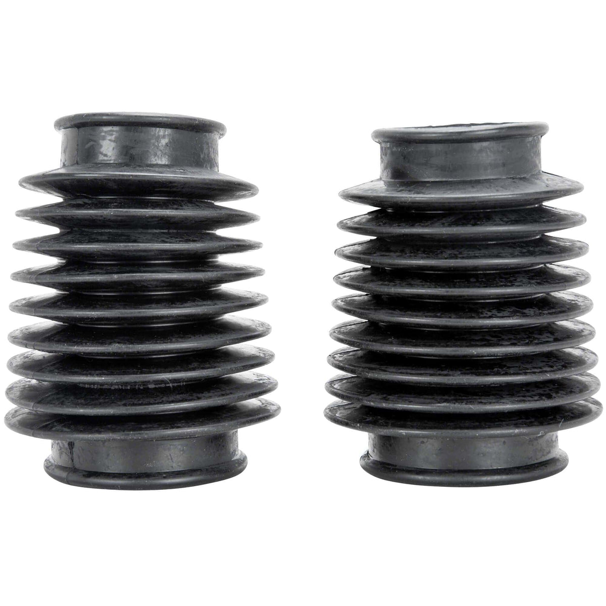

          Hi
          I'm guessing that NOS rubber fork covers (46001-54) aren't around any more, so can anyone suggest a supplier of good replacement fork boot rubbers that will fit into the original retainers?
          Steve

              • Peter Cooke
                • Aug 2012
                • 566
                Originally posted by Steve Little View Post
                Hi
                Steve
                Steve,
                I can't speak to quality or fit but it's a start.
                These top quality fork boots are top quality and made to last. Fit 1954 - 1970 Harley-Davidson Sportster XL models and K models. Sportsters in this year range a

                  Thanks Robbie. After your suggestion, I called a friend and he confirmed that it is Trumpy. I’ll give it to him for Christmas. Yeah! I know! I should be more astute when buying parts...but where’s the fun in that.
                  Thanks for the lead Pete. I have an inquiry in with partslegend but will keep lowbrow in mind.

                      The factory fork boots were available as late as 5 years ago, I can't imagine why. Old Dude has some boots listed, too.
