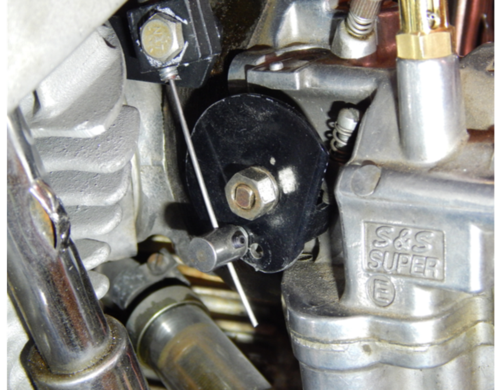

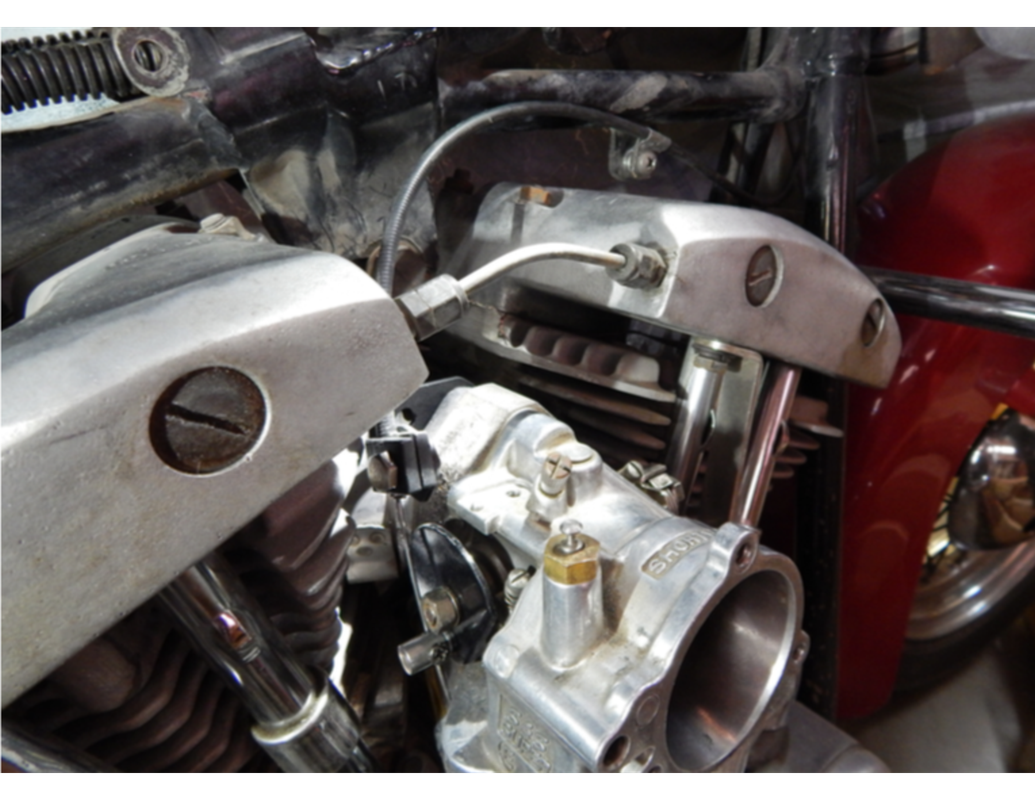

        My brother got his 68 finished up. He made a new cable clamp and throttle spool (disk). Here's what he said.
        I’m at the point where I’ve got to call this project “done”. It works consistently. The throttle movement is smooth and consistent and it returns to idle all the time. Here are some images:
        Looks a lot better than the S&S teardrop.
