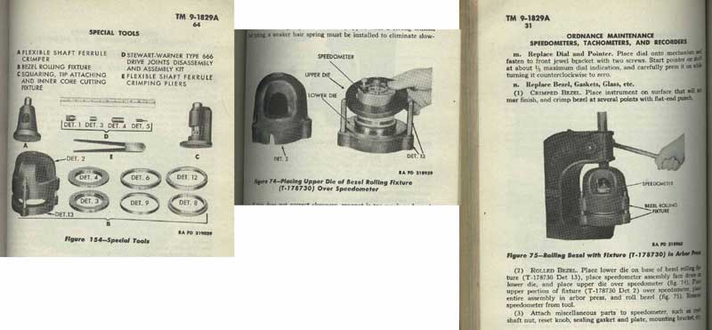

        Mark - the bent screwdriver and bezel straightener should be self explanatory so I assume you're interested in the bezel roller. Yes, I have one and even though I paid big bucks for it and routinely use it happily, if I was starting from scratch I'd likely make a press type tool to roll the bezel on. The factory came up with that unit because they had several different sized speedo bezels to roll. Since all the 509 series speedo bezels on Harleys are the same diameter a press unit would be a lot more straight forward to make. I'll attach a couple photos showing what the factory supplied press units look like (that my "chain roller" superseded). First picture is what Stewart Warner supplied to the military during WWII ... Perry

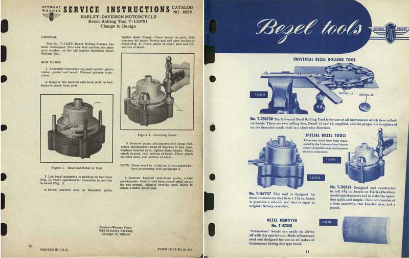

          And here's Stewart Warner's earlier Harley bezel roller ... Perry
