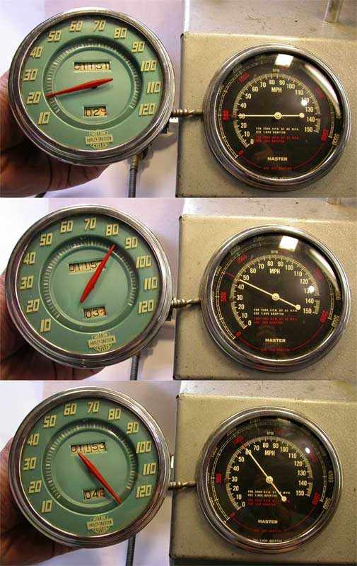

          Now, regardless who you have restore your speedo, get a recommendation from someone who actually rides their bike. There are lots of cosmetically decent speedos that don't work worth a bean. I've had to fix probably half a dozen "restored" speedos in the last couple years that were not even close on either the speed indication or the mileage recording. I'd like to think it's ignorance on the part of the person that originally restored them, but it's probably malice. So y'all can see what I'm talking about, I'll attach a montage showing the same speedo before and after.
          You've got to wonder about some buyers too tho. A couple weeks ago a Corbin sold on eBay for $1300. In the description the seller said "I ran this hard on the drill press for two hours and it worked fine.". How the h-e-double hockey sticks do you calibrate a speedo using a drill press? If that was what I was using I sure wouldn't brag about it in my listing. If I was a buyer I'd run (not walk) away but instead someone cheerfully forked over their hard earned cash.
          Anyway, here's the before picture. Speedo as received on the left. Calibration machine master on the right (which is checked periodically with a strobe tachometer). The only reason the speedo stopped at 130 when it should have read 60 was it had hit a hard stop internally and couldn't go any faster. It wanted to. This is typical of what some people fob off as a restored speedo ... Perry
          • Perry Ruiter
            And here's the after of the same speedo. Not every speedo tunes up as nicely as this. As I recall I installed a matched NOS hairspring so that helps. Keep in mind, especially on a big twin, a speedo is, at the best of times, an approximation since the same calibration is used on a bike with 18 inch wheels and a 21 or 22 tooth tranny sprocket ('cause it's pulling a sidecar) as is used on a bike with 16 inch wheels, low profile tires and a 24 or 25 tooth tranny sprocket ('cause it's a solo bike). 45s fair better in this department since their speedo drive is off the rear wheel and hence the tranny sprocket is taken out of the equation ... Perry

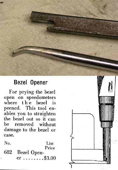

                        You obviously do excellent work. Just out of curiosity, I've always wondered how you guys "opened 'em up" to restore them. It looks like everything is sealed up, could never figure out how to get inside of one without physically messing everything up, is this a "trade secret" ??
                        Mike
                        • Perry Ruiter
                          Brian - I already had an expression of interest in the dash assembly. I just sent photos tonight. If the person decides against it, I'll contact you.
                          Mike - I don't think it's a secret - like any specialized area of service, be it motor or tranny building, etc. speedo servicing also has it's special tools. I'm a bit of a toolaholic. If there's a special tool to do a job, even if it does it only imperceptibly better, I like to have it. Of course some things are impossible to do without the proper tool. I've spent literally several thousand dollars just on speedo tools. Considering I only work on maybe 8 or 10 speedos a year it'll be a while yet before I'm out of the hole. There's still more speedo tools I'd like to have. I've missed out on a few by not being aggressive enough.
                          Anyway, bezel removing doesn't need a special tool. For years I just used an old screwdriver with the tip bent. Finally I was able to get my hands on a real tool. It works really slick on panhead/shovelhead bezels. Work your way around the bezel with it and you'd never know it had been rolled on. The shape of knucklehead bezels is just different enough, that it doesn't work as well there and I usually still resort to the bent screwdriver for them. The catalogue caption is from 1939 ... Perry
