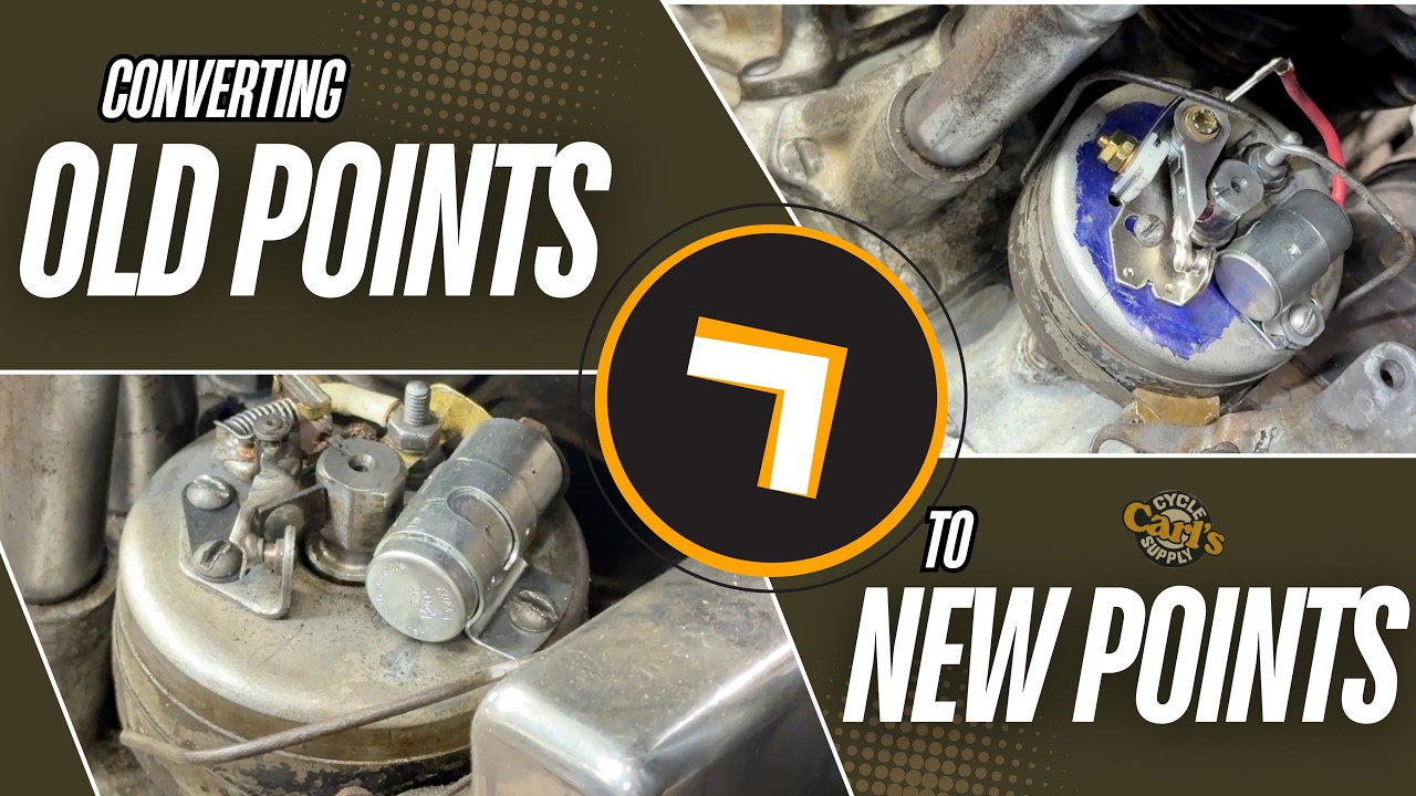

                      Carl and Matt Olsen recently posted the video below (I hope its ok to post here) on modifying a 48 & earlier timer to use Blue Streak points. I personally don't know if a similar modification could be done to later model timers.
                      In the video he shows the VTwin packaging for the Blue Streak points he used (for a 70-78 FLH & 71-78FX).
                      32-0156 (points) & 32-0157 (condensor).
                      (credit to Carl's Cycle Supply).
                      Jim
