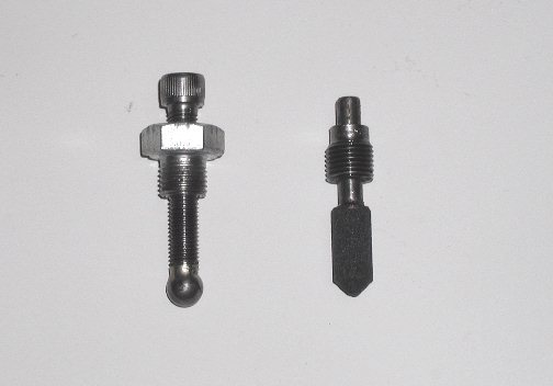

                  When inspection on the bench shows peculiar damage to the seat, from punching or whatever, I use a piloted conical stone first, by hand. Some rusted extremes even required attacking the well with an endmill on the Bridgeport in order to narrow the seat, just like a motorvalve.
                  Attached is a pic of a burnisher and the piloted stone; Beware of course, that if the casting has been cracked by a savage beating with a punch some time in its long life, nothing short of a seat insert would save it.

                        The burnisher is a simple screwpress, as shown in my last attachment. Anyone with a lathe and can silversolder should make one.
                        (I commissioned a few, but my sub got way out of hand, so I must get $50 a piece just to break even. If you want something done right, you better do it yourself...)
                        For an even better burnisher design, and professional service if you need it, try Steve at http://www.resurrectioncycle.com/
