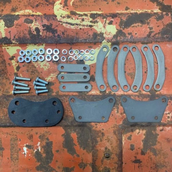

        Just wondering.. you didn't say what year springer horn.. there are different mounting set ups depending on year. Guessing you are talking late mount since early has rubber. I am assuming you have the correct hardware? the top mount takes special bolts with a shoulder that go through a spring plate. The shoulders bottom out before the spring plate is crushed. this gives it some play and also helps from keeping the horn bracket from breaking itself. Here is a picture of the special bolt with spring plate. You can see in the hole of the spring plate how much play the shoulder bolt actually gives you. Different years used different shoulder bolts. Don't know if this helps or not. Might help someone.

                Lots of parts mount that era horn... Here are some pictures of an original with mounts attached. Bottom is actually mounted with spring steel plates to the fender mount with shims. link is kind of a parts blow up of a horn mounting kit.
                1936 - 1941 Horn mount kit (except VL). MADE IN USA by your friends at strange bird manufacturing.

                    Thanks for the pictures. I knew I had a 6 bolt horn, not a 9 bolt but I didn’t realize the mounting was totally different. Parts book wasn’t much help and Palmer didn’t have a picture of a 9 bolt, just a description. I will have to prioritize finding a 9 bolt and make due until.

                        Its not hard to turn your later horn or a hummer horn into a 9 bolt.. Drill a few holes, fill a few holes, take the plate off the back and change some hardware. You are all set.

                            6 & 9 screw horns mount the same way.

                              I thought only the 6 bolt horn has the steel bracket attached to it?
