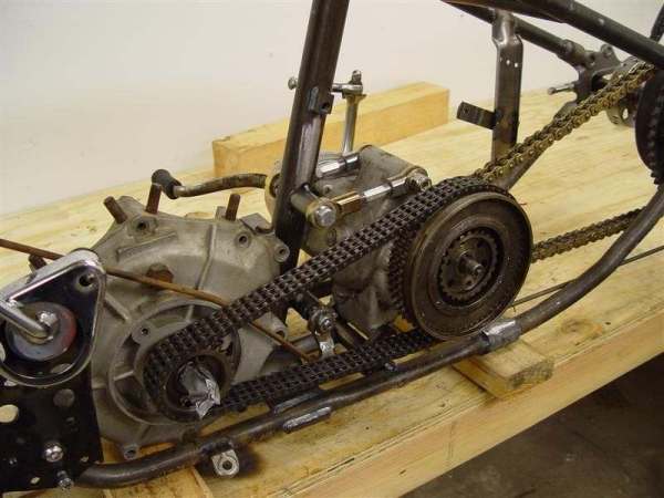

                        • #13
                          heres a picture
                          of the driveline
                          • #14
                            Pretty ****ing cool!!!
                            d.
                            • #15
                              It really saddens me that you couldn't find a rear head. Say your motorhead prayers - keep looking..... cool that Jeff & fam is helping you out. Good on him.
                              I like the adjustable trans braces. Great solution - looks good!
