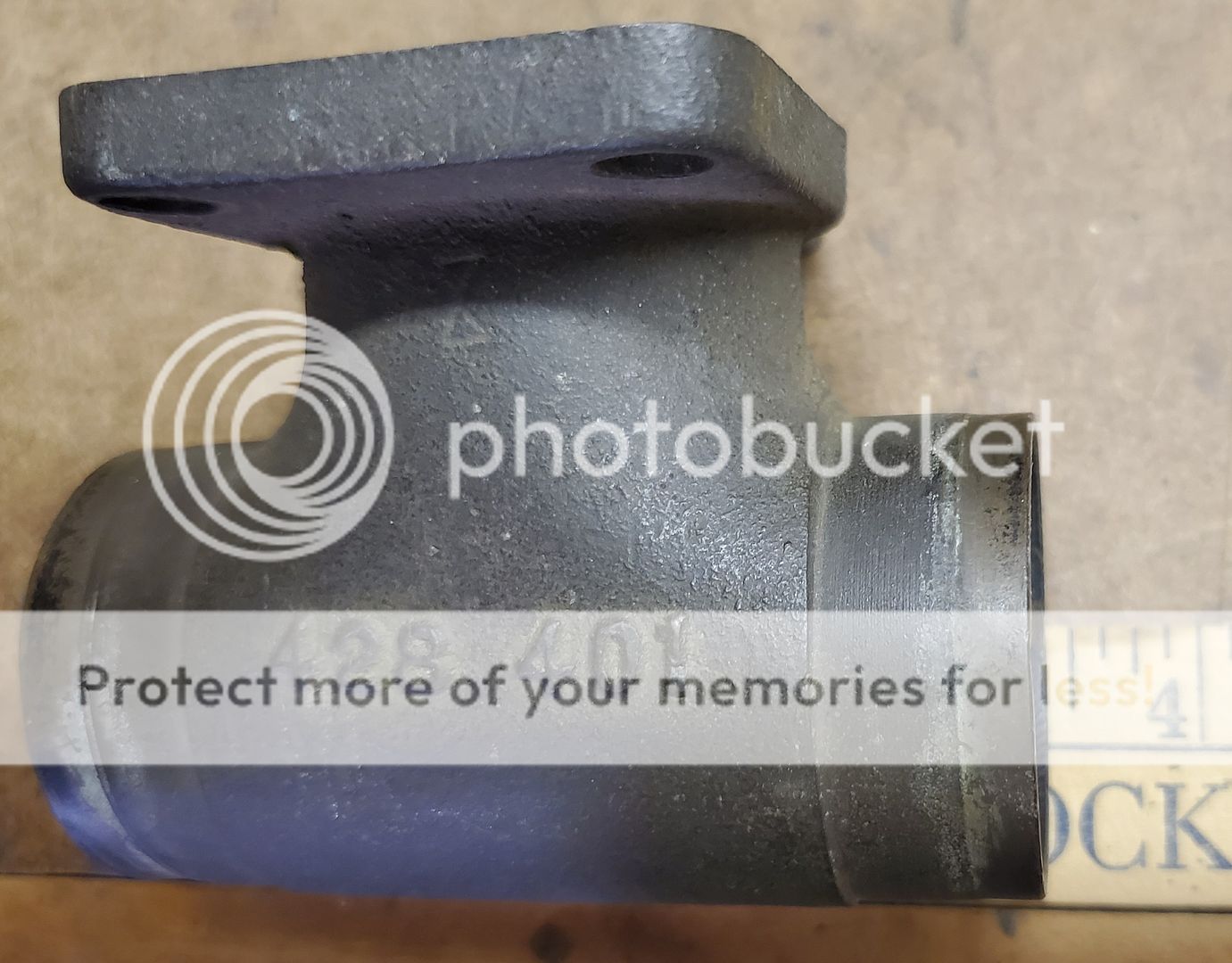

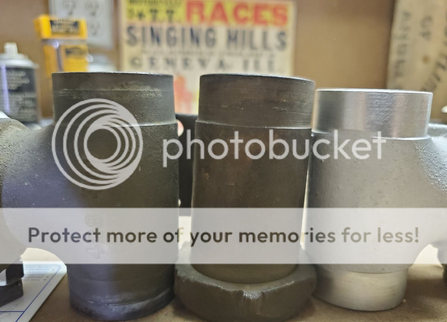

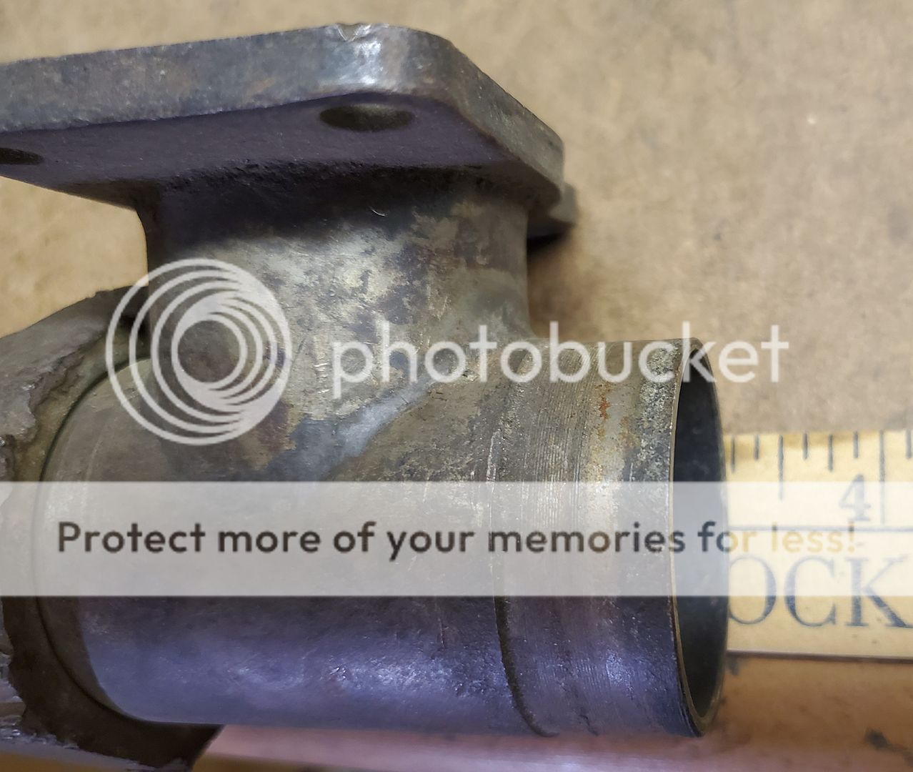

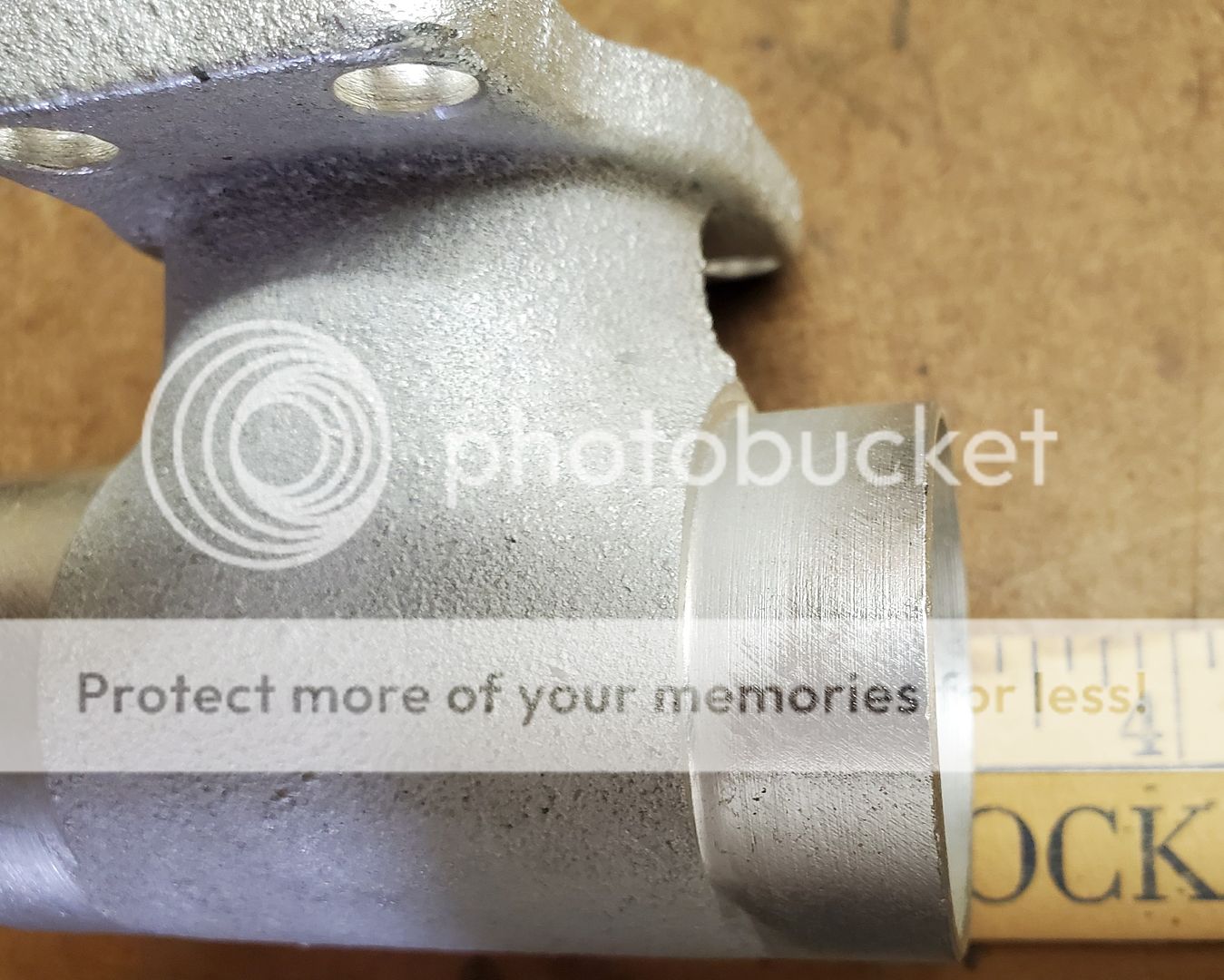

                  I have three different lengths. Very close but different.

                    Thanks for the pics Chris. I never looked into the production numbers, but it seems that a lot of 61's were produced and a lot of their manifolds survived as opposed to the 74's.

                      The question Craig,...
                      Is which were actually produced that way by the MOCO.
                      PS: Chris!
                      Your manifold in your pic #3 is what I call a silver-soldered steel manifold, for '48-'49.
