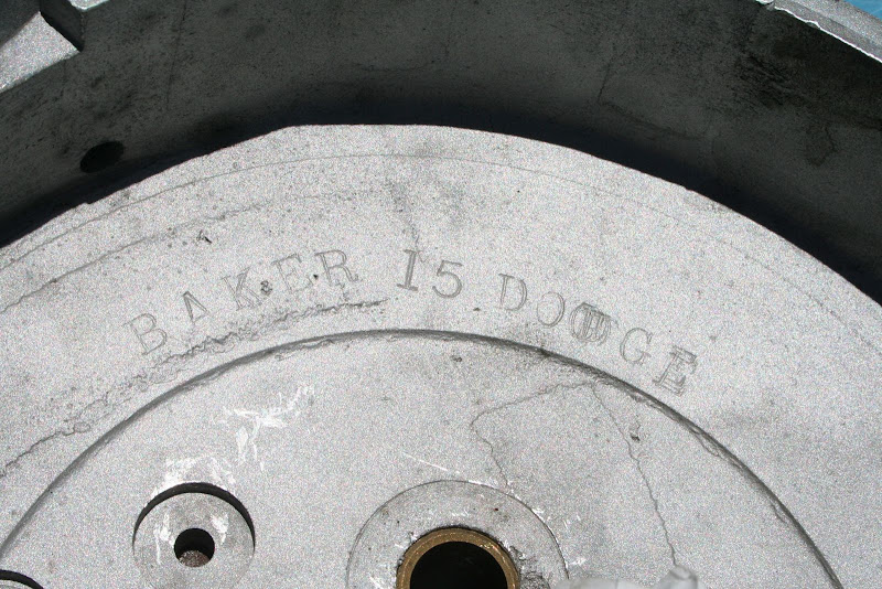

    Here are some case numbers that I have.
    Maybe you can help me identify them.
  • marsh1915hd
    • Mar 2009
    • 297
    The first case is elc. md. 1916, L 13074 M, with belly #'s N 848, The next one is left side case belly # J 194. The next one has been stamped with 1919 #'s but is a 1916 and down case. Not good #'s with belly #'s of P 4, Next is a Left side case with belly #'s of T21. This case has some funny lettering on it, with writing on the inside. Baker 15 Dodge, CB 15, belly #'s of T21CB.

        • marsh1915hd
          • Mar 2009
          • 297
          This was just a greasy case till I cleaned it up. Cannon Ball Baker didn't race for Harley in 1915 at Dodge City. This case was bought 12 years ago at a swapmeet. It looked to me like the writing had been on there many years. Did Baker ever race for Harley?
