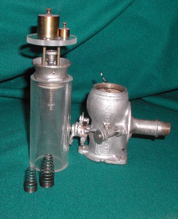

                              Airvalve tension for 3/4" models?
                              First, I wish to thank Tommo for his generosity with priceless information!
                              Using his direction, I made a platform where I could adjust the 'fluttervalve' tension accurately without my jittery five thumbs getting in the way: (attached).
                              I can get a 1 1/4" model with the larger spring into the 5 ounce range, although a bit compressed. But it seems obvious that the 3/4" models, with the lighter spring, are designed for a lesser tension. Otherwise, I must thread the shaft nearly to the valveseat.
                              With valves of nearly the same diameter, it only confuses me further...
                              Thanks in advance again for any help at all!

                                Hello Cotton: I am looking for your pic you submitted a while back of your mod H Air Valve tester. I recall seeing it before this site got modified a few months ago and many pic attachements were lost..thanks in advance...Joe
