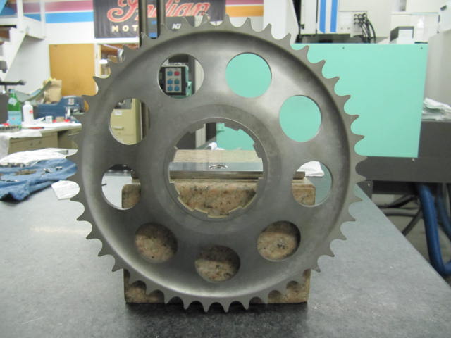

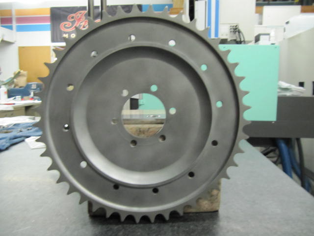

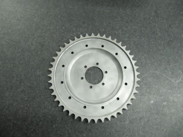

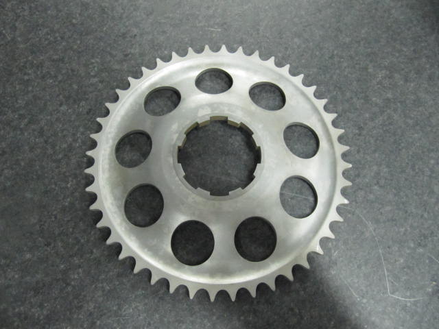

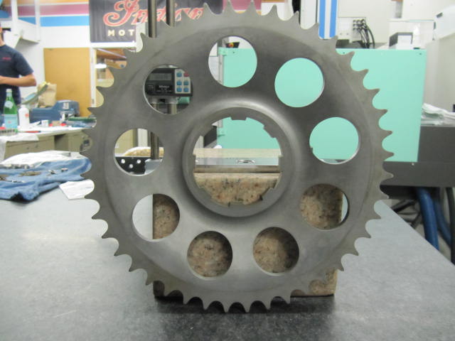

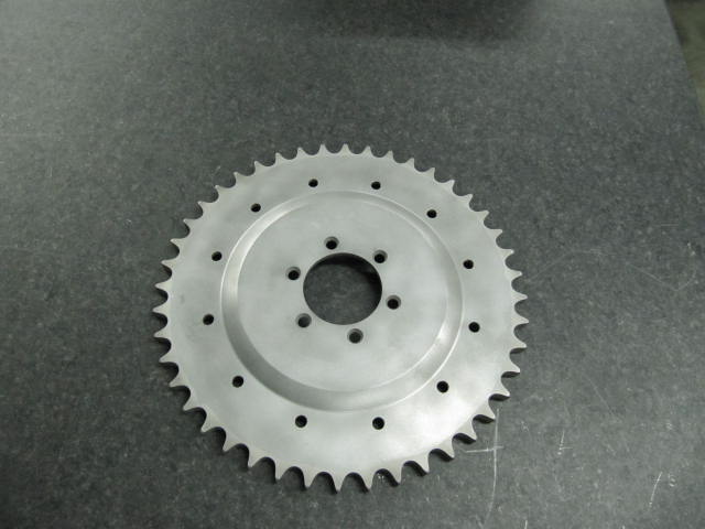

    I ran a batch of JD wheel and clutch sprockets. I have 44 tooth wheel sprockets and 43 and 44 tooth clutch sprockets. Material is 8620. The teeth are carburized .060 deep. The clutch sprockets are $250.00 and the wheel sprockets are $275.00. They will be ready to ship on Wednesday, July 18. Here are a couple of shots before heat treat. The spline for the wheel sprockets is wire edm'd last, hence no spline in the pictures.

        Attention.
        It has been brought to my attention as a function of the photo that I posted of the clutch sprocket, it appears that it includes the center hub/race. It does not. The picture was taken when we were checking fits and mocking everything up. I have been looking at these for so long I completely missed it. Sorry for the confusion.

                Greetings,
                The first batch of sprockets are back form heat treat. I've been cutting splines in the wheel sprockets most of the afternoon. 1 1/2 hours in the wire edm ea. There is no fast way around that process. Shipped some today and the second batch will go out Wednesday and Thursday. The remainder will be shipped mid week next. Thanks to all who have ordered.
