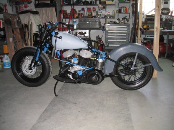

                          Hey Chris..... I'm still waiting to see a picture of your 45". I found the mock up photo you sent me awhile back. Remember when it looked like this..?
                            Just get it running. Things can happen over time.
                            • Chris Lastinger
                              First Run
                              Steve, Still looks like that only now it has paint and shines in sunlite. Little things never show like LineX instead of rubber for the foot pads and pedals, 45 shell case heads in place of a few washers. Just little things to make it mine. Odd little bike, just like the owner. Parts from 40 to 07----definitely not qualified for period correct. Might make it into the longest ridden catagory tho if I can just ride futher than those folks on idestuctable indian bikes. Smiles Always Chris
