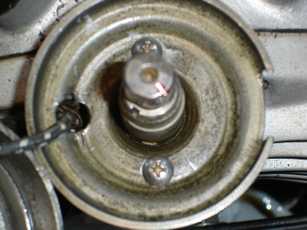

        With the flywheel timing mark proeprly aligned, here is the position on the breaker cam.
        Where should the mark on the cam be aligned?
        I appreciate the help.
        • P LaLonde
          ratfink,
          your 45 is not any different than my 38 80. so that hash mark in your photo,should point to the fiber on your points.
          Now on your distribertor base there is also a hash mark ,on the out side towords the bottom of the base. your advancer ring should have a hole in it. these Should be alined
          try putting your cap back on an advance the spark, check to see where the shaft pointer is now.
          you mite haft to pull your base an turn your shaft one way or the other a TOOTH.
          Hope this helps
          TooTall Paul
